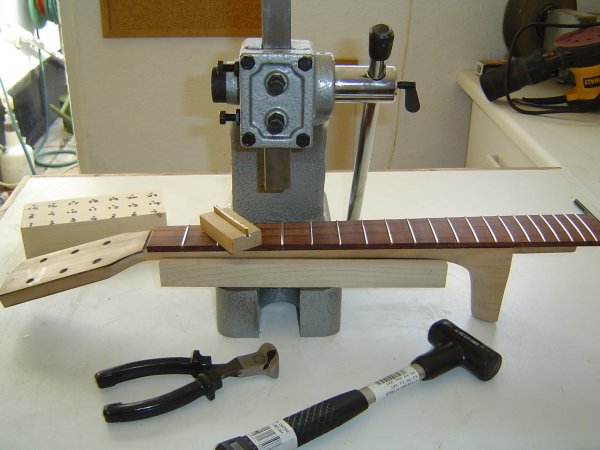

I'm a sort of hybrid. My building system means that I don't glue the fingerboard down to the guitar top but only to the neck and it's extension, which just fits a pocket on the headblock. I can therefore level the fingerboard after gluing it to the neck then install all of the frets.
I use an arbor press, just tap the ends in with the deadblow hammer then press them in using the radius caul simply held in a groove in a block of cherry.
Since using this method I have never had to level the frets or reprofile the fret tops. just dress the ends and job done.
