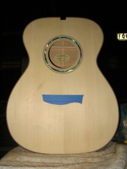

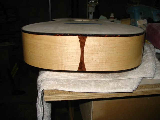

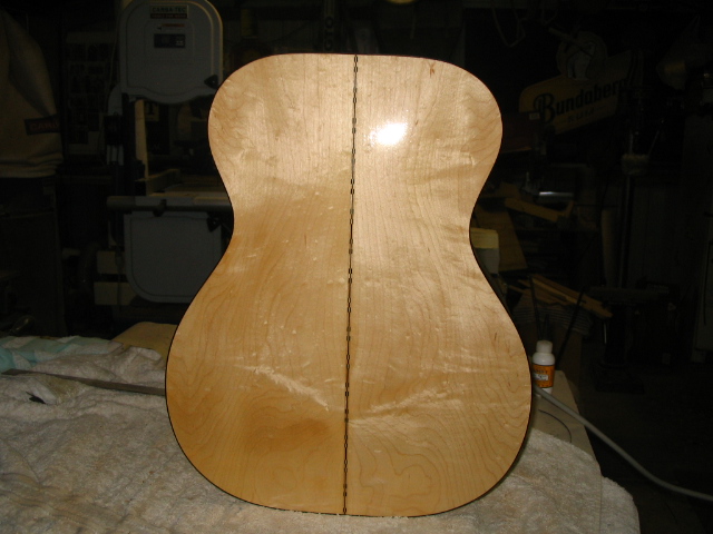

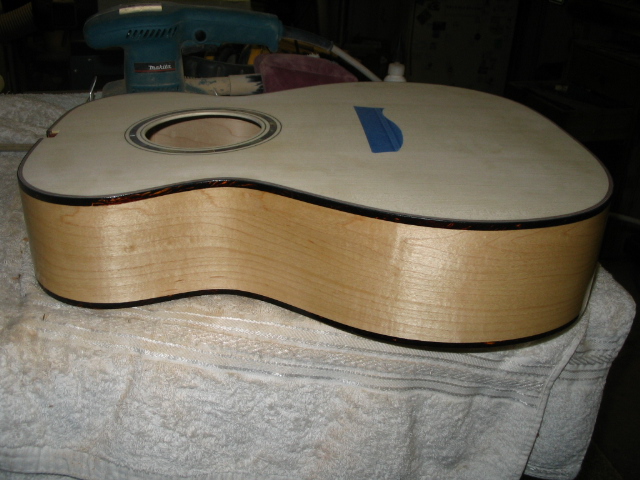

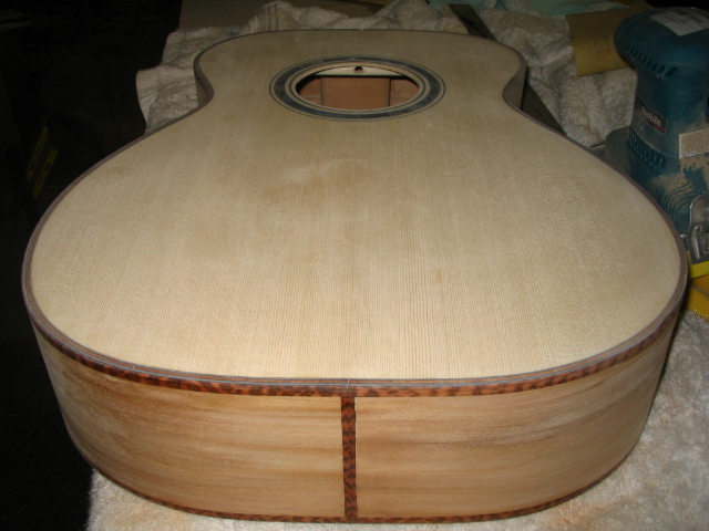

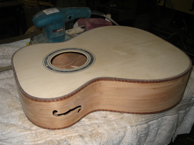

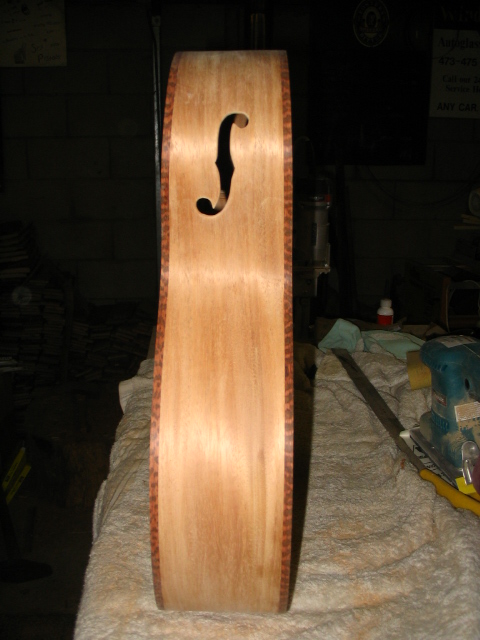

Here's a few pics of a couple of OM's that are starting to take shape.
This is about my favourite part of construction. Seeing the body cleaned up so you can get an idea of what the appointments look like.
BTW I haven't forgotten about the OM twins. I'm just having trouble finding the time to record them.
First one
Lutz, Mahogany, Snakewood, BWB/Blackwood/BWB purfs.

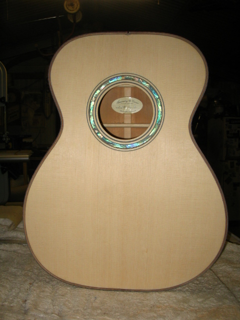

Rock Maple, Englemann, Tortoiseshell, BWB/Blackwood/BWB purfs.

Dave, the Mahogany one is for the DADGAD guitar that you and Colin kindly gave me advice on a few months back.
It's not parabolic though. The customer decided he like the the sound of scalloped bottom end.

Nice....and I love that "f" port.

Nice work Bob on both!! The "f" port is a very nice touch (quick trademark that). I really like the wide Paua rosette.

Looks great Bob! The sound port is nice!

Two incredibly  fine looking instruments./  I'll bet that maple was fun to bend?

af_one - I had to take about 1mm thickness off the snakewood through the thickness sander before binding.
It completely wrecked the sandpaper in about 5 passes.
Some serious resin in this stuff.
Rich - the Rock Maple actually bent really easily with no cupping of the sides at all. I seem to remember we got distracted when we were bending them and the temp got too high (about 180C (360F))whereas we try to use 150C as a max temp.
The smell of overheating wood alerted to this but when we took them off the bender they were fine.
Beast of a wood to sand though. Very tough.

Very cool! Nice soundport!

I'm delighted you used maple. And in case I haven't said this recently, let me add: I LOVE maple! My experience is like yours, it bends easily, but makes up for it in the sanding. That's where it resists your will for sure.

Very nice Bob. Was that sound port difficult to cut on the curved surface, or did you cut before bending?

The F hole sound port looks great but in any future ones I think we'd be looking at a different shape as the little pointy bits (that's a technical term) are very fragile. ie stylising it a little to leave out the points.
We put a veneer of Mahogony on the inside of the sides under the F hole to give it more support as I don't think they would have lasted very long as they were.
John - the F hole was cut after the sides were bent but before the top went on.
Steve - this Hard Rock Maple is tough. Put the random orbital on it with 100 grit and it just shouts back - WHAT ELSE YOU GOT !!! Don't have to pore fill it though which is a bonus.
I'm looking forward to hearing the Maple one. It's got an Englemann top to try and diffuse some the Maple fundamental tone, a Maple neck, which should give some nice sustain and it'll have a gidgee bridge weighing in at 36 grams to try and tame the top end and give an impression of enhanced bottom end.
Here endeth the theory lesson!!
All will be revealed when the strings go on.

Very nice! I like the 'f' hole and the rock maple.

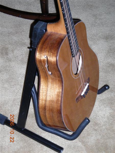

Very nice Bob! You are really spitting these out quickly. I love the F hole sound port too. I did that on my Bouzouki last year. I get many comments about how much they like the soundport. Here is a pic of mine done in Koa:
I was going to do it on a tenor ukulele too. Thanks for sharing your builds. Love to see what others are up to.
