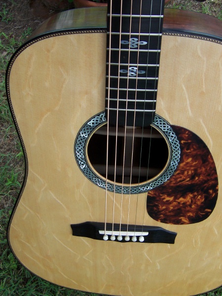

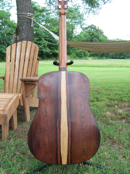

Well it took 4 1/2 months, but I finished the Celtic themed dread for my pickin' buddy. He won't see it for a few days, though, as he's somewhere in Texas, fishing.
It is madagascar rosewood with an exceptional bearclaw, master grade sitka top, standard scalloped bracing, ebony trim, fb, bridge, headplate. Bone nut, saddle, and pins, and although they didn't photograph nearly as good as they actually look, it has real MOP tuning buttons (Andy) on Schaller tuners. The MOP rosette and fb inlay knots came from Andy, too.    Only had strings on it for a couple of hours, but it sounds great!!!
Hope it meets your standards.
Thanks for looking,

ron, i think you did a great job. excellent choice of woods and appointments. very clean and very very nice.

Very sharp looking guitar there!!! I really love the wood choices throughout. One question: How did you put new buttons on the Schaller tuners? Mine (open gear) don't look they come off easily.
Beautiful guitar!!!!
Christian

Man, that looks really nice.  I know you'll have a happy Pickin' Buddy after he sees that.  Great job!

Simply beautiful. Just wants to be picked up and played!

Christian, on these closed tuners all you have to do is remove the screw in the end of the button and they slip right off. I did have to work on the pearl to make them fit, though. The holes were hand cut and on a couple of them, I had to file the hole a little and flatten two sides of the holes. Anyway, on the Schaller closed tuners it is very easy to change buttons.

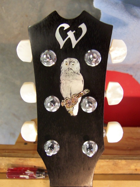

I realy love the owl you put your head plates.
PostPosted: Tue Jun 19, 2007 1:46 am
Ron, I love the owl too, but look at his eyes.  He looks to be saying, "How did I end up here?"

Very nice Dred. Ron ! Man,that must have been one angry
bear to claw that top like that! It's gorgeous!
Your owl logo is so cool too !
What did you use for the finish ?

I think I may have said it before when I looked at this guitar in the white but I'll say it again. Your skill as a builder has come along leaps and bounds. I am not rubbishing the guitars that you made for your boys, they were great too, but this one really is first class.
Well done mate

Ron, you are one of the guys who set the bar for the rest of us. Really well done

Dave, the finish is tru-oil over shellac.
Also, need to mention the b/s wood came from Vikwood, not a sponsor, but I bought it a long time ago.    The top, however, came from Steve, at Colonial. I bought three more just like it a couple of weeks ago. Fabulous stuff.

Nice looking git .. love the bearclaw, and of course the mad rw, very sweet ...

Ron, that guitar of yours is a real stunner. I absolutely love the mad RW and the Celtic MOP rosette! I don't make steel string guitars (yet), but you and others have influenced me to liven up my creations with some of those awesome woods and non-traditional (for classical and flamenco) appointments.

My gosh, I gasped when I saw this one. The bearclaw and the celtic rosette are absolutely breathtaking!!

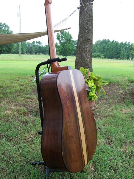

Very stylish Ron! And a beautiful Hammock-side setting for a beautiful guitar.

One HOT Dread.!!
Nice choice of materials and work !
Is that a zero fret I see?

Mike, that is a zero fret.
