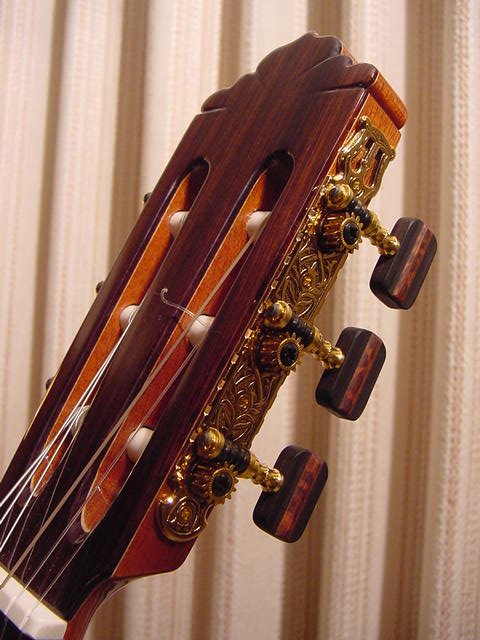

Christian,
Here are two photos of a set of ebony & snakewood buttons that I made mounted on Gotoh classical tuners. They were a fun side project and the Gotoh tuner buttons are removeable with screws on the shafts so they didn't have to be pulled off with any special tooling.
Peter

Those look really sharp, that is part of the reason I wanted to do it - it could be a laminated piece. Thanks for the pics! Was this a difficult process?

Christian,
I took a 6" long piece of ebony and routed the slots on each side to inlay the snakewood. The snakewood was a leftover piece of binding. If you look closely you'll see that there still is about 1/16" of ebony between the two inlaid pcs. of snakewood.
After inlaying the snakewood I drilled the holes for the tuner shafts using my dremel drill-press set-up. I then cut the log into the 6 pcs. and used a very small modelmakers square file to square the holes in the buttons so they don't spin on the tuner shafts. The last thing I did was to shape them on the belt sander and some final filing and sanding with 600.
Peter
PostPosted: Mon Jun 18, 2007 1:54 pm
That's nice work Peter. The snakewood kind of looks like tortoise shell (the real stuff) in this application.
