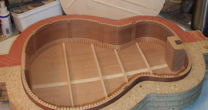

That's the way I do them too, although I'm still struggling with the "real even all the way around" part!
One more thing; the side braces are a few millimeters shorter than the height of the sides. That way, should the sides shrink with humidity, the braces will hopefully not push the plates out.
Here's an old picture:
