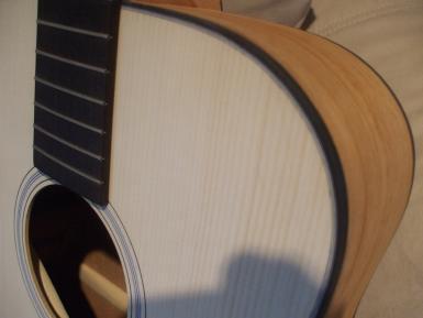

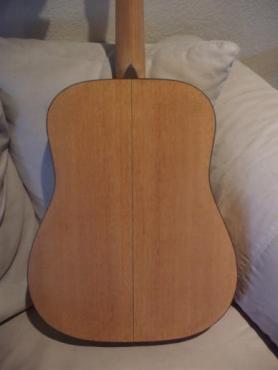

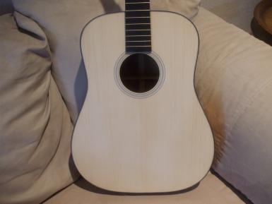

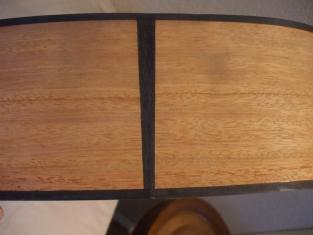

This is my third attempt at this stuff. 1st ok second a disaster. Any suggestions for the finish? Color? There have been so many of you who have helped with your posts and pics, so thanks for being there.
Wisdom is justified by her children
PostPosted: Mon Jun 18, 2007 3:09 am
Robert Dobbs (Robertandsons) used True Oil for the total finish on his and it looked great.  He was really pleased with the results and the ease of application.  Check with him, or wait, and he'll probably chime in since I have invoked his name.
PostPosted: Mon Jun 18, 2007 3:12 am
  That was rude!  Really nice looking guitar.  Very neat work.
PostPosted: Mon Jun 18, 2007 3:59 am
Great looking axe, Max! Sorry to hear about your second turning into a nightmare... The dreaded sophomore curse is alive and well, I see...
As for finishing, as Hesh stated, if you don't have spray equipment or a safe place to do so, French Polishing is a superb alternative.
I've also seen a few gorgeous guitars finished with KTM9 and they looked fantastic, to say the least....
I think the quality of your finish has everything to do with surface preperation and rigorous pore filling. If you substrate is free of imperfection, you'll be way ahead of the game.
Good luck!
