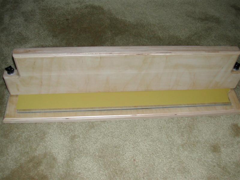

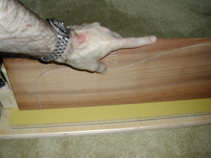

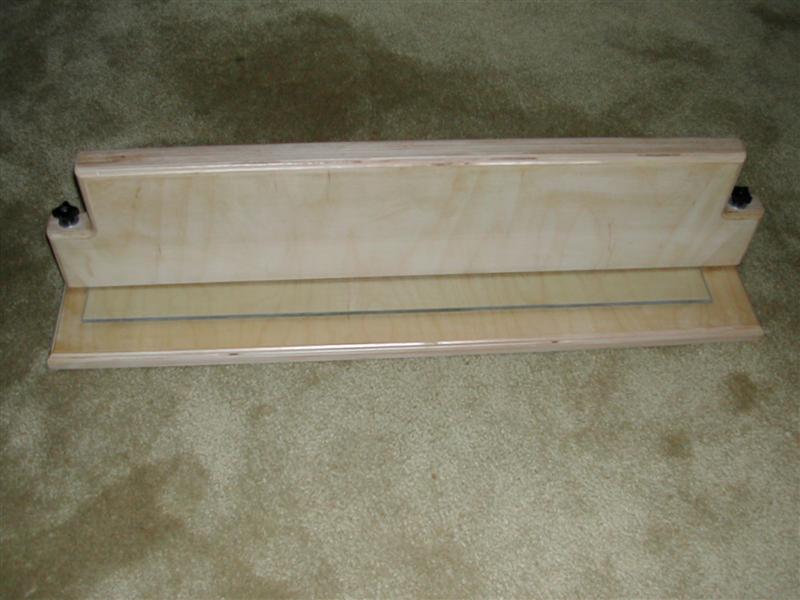

Great question Stefan, and perfect timing! I have a jig that is about to be released next week sometime that will solve this problem. It was designed by Edward Victor Dick, and is used in his guitar building school. He has built over 355 stringed instruments, and has been jointing tops this way for the past 15 years. It is basically a fence with a flat surface(glass) with sticky sandpaper on it. He uses 80 grit sandpaper, but 100 or 120 will work fine too. He is usually done in 5 minutes, and is a really fool proof way of jointing anything. Because the jig is so simple, we will be selling it for $40. We are not making much off of it, but then again, our goal is to make products that make your job easier.
Anyway, here are some pics of the jig. Feel free to make one yourself, but if you can wait a few weeks, you can own one like this. Good luck!

Thanks guys! Hesh, good point, and that is the purpose of the bolts on the end. You loosen, lift the fence up and slide the glass in or out for a fresh section of sandpaper, then tight down again. Works like a champ!
Another cool tip, sometimes people tend to sand more on the ends, leaving a gap in the center. Add some tape to the bottom of the glass in the center and tighten down the bolts. This raises up on the middle area and allows for a perfect job. I'll have video of this process and adding tape once I get the page up, so you can see it in action.

Something I have found that works with this method (I have a similar jig that I sometimes use on my granite block when I struggle with the plane) is to only sand in one direction. That seems to minimize the gaps on the ends.
PostPosted: Fri Jun 15, 2007 5:36 am
[QUOTE=LuthierSupplier] Add some tape to the bottom of the glass in the center and tighten down the bolts. [/QUOTE]
Bending glass?! Danger, Will Robinson!!!!!!
You've apparently done this without breaking the glass, Tracy, but in my experience glass doesn't like to bend. I snapped a piece just by laying it on a non-flat surface and applying some pressure.
