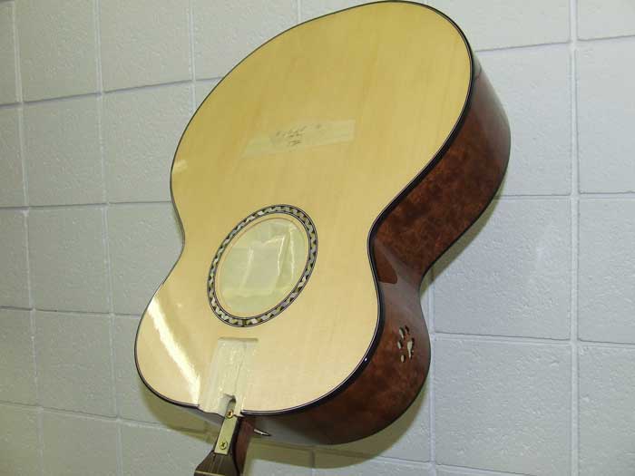

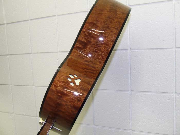

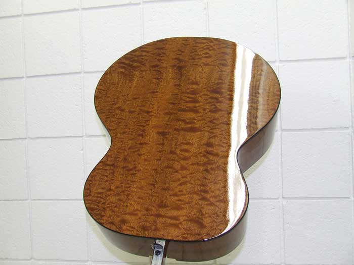

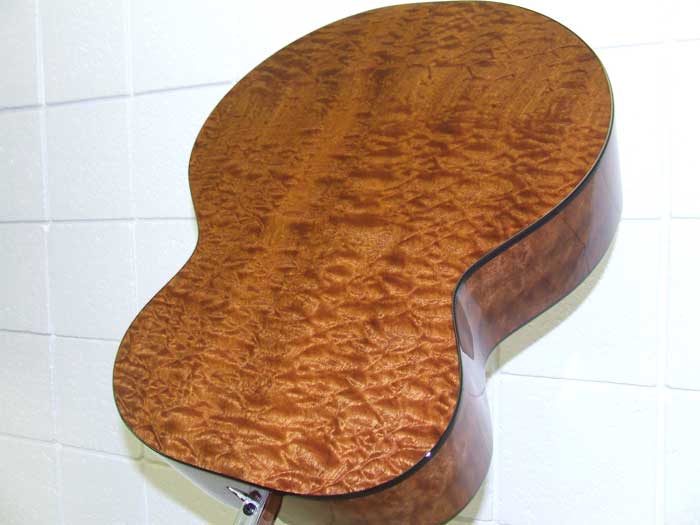

I guess Tony was taking picts today.
I too got a email from Tony
This is my 12 string Lutz/Quilted Sapele OLF SJ!!!!!
(Shane and the Zootman)
This one will have my 1st BURST!!!!!!!
A very light golden brown burst.

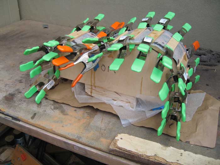

Basically I have made an inside half mold that is a bit smaller that the guitar. So when the sides fit over it it is the correct size. I just use thin cauls and spring clamps.    Very easy. I routed a channel in the mold to hold the clamp.

Here is a pict of my clamping.
There is wax paper on both sides of the wood to prevent me from making my mold a single use item!!!!
The clamps just fit in the groove I routed in the sides fo the mold. I have made a mold like this for each body shape. It is just a bit smaller then the guitar to allow the thickness of the sides to give me the right dimensions
