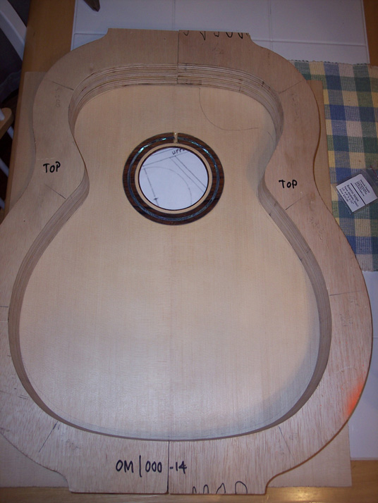

I have plans on the way but I was wondering if anyone here could let me know the soundhole diameter on the OLF OM. See I thought I was going to wing the size/shape/bracing pattern with this first build, but I decided to go with something more tried-and-true. I already did the rosette and cut out the soundhole, so I am hoping that mine will match up to that.
Thanks!
Christian

I also recently ordered the OLF plans and haven't received them yet, but I do have the plans from the book that I have (not sure if it's standard though), and it says the soundhole is 100mm or 3-15/16in (I guess basically 4 inches).
Someone else who's already familar with the OM could probably verify that or tell you otherwise.

[QUOTE=blain1976]I could tell you for a couple of Bending forms and a mold. (Just kidding)
Sry!
Ok, lets just hypothetically say that my soundhole ID is 3.7 or so (without the soundhole binding it would be more like 3.9) .... is this going to make a big difference in the sound/volume?? Aesthetically it looks fine... I think anyway.
Christian

A smaller soundhole will make a difference, but whether or not you will actually notice it is questionable. There will definitely be a little less volume. Yours is so close to the 4" required that I dont think I would sweat it if it were me.
PostPosted: Wed Jun 13, 2007 8:25 pm
I use 100mm for OMs (and just about everything else) say 4" in old fashioned measurements.
Yours at 3.7" is on the face of it only 0.3" smaller. However this is a larger proportion of the area than the 0.3 would seem at first sight, as this is taken from the outside edge so would represent the difference in area of a circle 3.7" and 4". The difference is more than 1.8sq" or nearly 20% bigger. that is not inconsiderable.

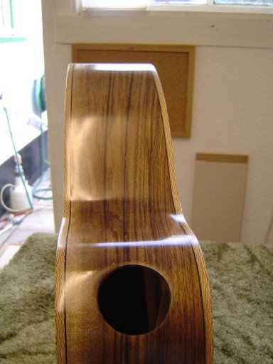

My solution would be to add a soundport in the upper bout, this is easily done and will offset any reduction in soundhole size (they add a great quality to the perceived sound anyway.)
Something like this:

You can cut a soundport at any time during the construction. Some cut them before bending some, after bending when the sides have had the head and tail blocks glued in place. I do mine after the back is on but before the top.
That said I have successfully added a soundport as a retro-fit to some of my guitars, no need to take them apart.
