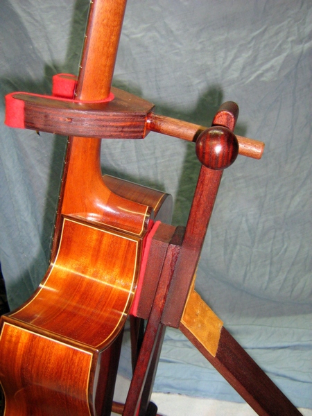

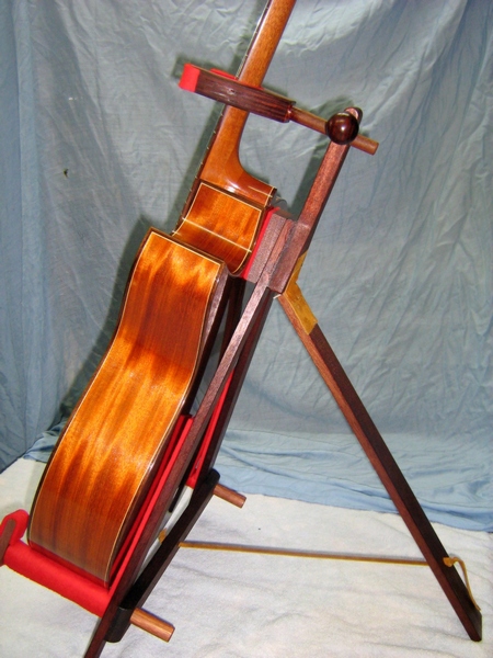

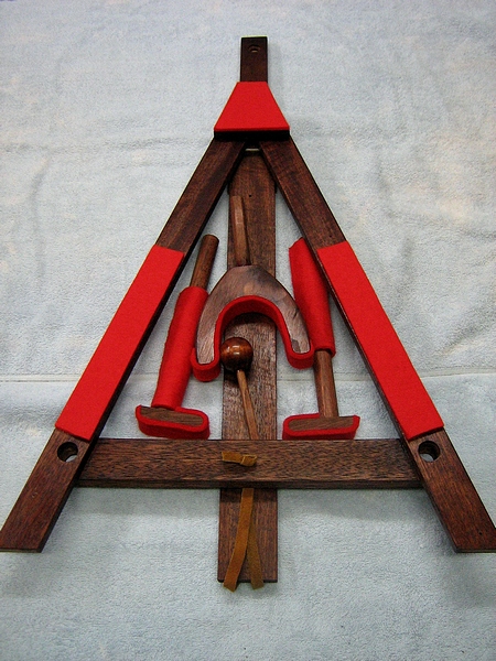

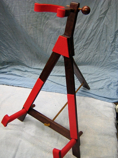

I,ve not been happy with the store bought stands , so knocked this together .It snugs the guitar very well . The neck support is easily adjustable for different width guitars via a simple wedge ( with the round handle ). The angle set can be adjusted by lengthening the buckskin strip . I used no metal ( leather hinge) and cushion felt from my piano supplies .

Thanks Colin and John. I've noticed the store bought ones are made to suit electrics as well , and as such have a narrow width between the bottom lower bout rests. Mine is for acoustic guitars , and has this width wider . As you can see , it supports the guitar at the lower bouts , back of the upper bout and adjusts to support the neck as well.
I came up with this design on the fly , and was so impressed with it's performance , considered making some as it flat packs.
You're welcome to use the design , but would like it referred to as the Lawrence of Australia Stand
List of materials include wood, leather, felt , hotglue and a bit of shellac . Sort of Old World ingredients .
As I said above ,it is very stable and supports the guitar better than any others I have seen
