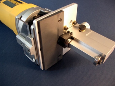

Now days I use neither. instead I use this hand held system from luthierstools.com. I really like it because it uses 2 bearing. one at the lower edge and one near the cutter to maintain a good square cut. With it you can cut the binding ledge first if you wish.
I find it much more versatile than the Ribbecke rig that LMI sells

Is that hand held machine as accurate as the LMI machine? What are the down sides to that thing?
A LMI jig may not work well for me because I do build cutaways.
PostPosted: Mon May 21, 2007 6:21 am
Every bit as long as you control it properly. If you keep both bearings on the side at all time without causing the sides to deflect in; then in relationship to the sides is more accurate than the Ribbecke as the Ribbecke indexes only by one bearing on the side and holds a vertical plane based on the fixtures tower. This requires that you index in the body's sides to be true parallel to the tower to be as accurate as my hand held when proper contact is maintained.
That is what I like about the hand held with two bearing system. set the depth and width of the cut and go. Channels are parallel to the sides every time.
I works on the same principle as the one at guitar Jigs but you move the router instead of the guitar
