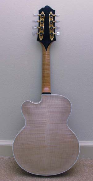

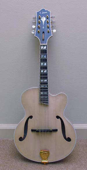

A while back I began building a pair of mandolins. The body shape is based on Benedetto's archtop guitar blueprint; my thought was to go through the process on affordable woods, on a smaller scale, before taking the round-bottom plane to a $200 chunk of maple. This was a great idea on one hand - it sure has helped to get familiar with the process. It was a lousy idea on the other hand - mandolins are small, and tolerances are tight. Anyway, last weekend I put a coat of shellac on the neck of the first of the two mandos to protect it, and strung it up in the white. Pics below. The second mando is for a friend, who wanted the peghead to resemble his '49 L5 guitar, which presented something of a challenge. You won't have any trouble recognizing it from the photo. Photo doesn't do any justice at all to the beauty of the pearl, of course.

I want one!

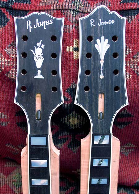

They are beautiful, the detail work on the headstocks looks very clean. Are you keeping them blonde? We need more pictures!
Very true.

Rick - great work.  Both of those necks and headplates are beautiful. They are going to be knockouts under finish.

The second one - the commission - will be a fairly dark yellow/amber, to hopefully match his L5 guitar. I'm still on the fence about mine. I've not done a sunburst before, and am really tempted to give that a go. I'm finishing with Target USL. I've got the StewMac guitar finishing book, and have been poring through all the forums reading up about finishing, etc.
Whatever I do, I want it to be something that would look good on the matching guitar, which I'll be starting on when these are completed.

Nice Job Rick!
Very sweet looking combination.
How does the sound compair to a regular Mandolin?
What is the scale of this one?

Scale is the 'standard' 13-7/8". Bodies are sized so the neck meets at the 12th fret - I think the reduction from the full-size blueprint was 64%. They are parallel braced, and braces are position according to F5 mandolin blueprints.
It sounds loud to me, and punchy. Lots of ring. I visited a mando player friend last night who owns half a dozen fairly high-end mandolins - three F-styles, an A, and one much like the one I'm building. This one was right in there with them, by both my estimation and his (I trust his opinion more than my own, for a number of obvious reasons). Will be interesting to see how it changes once a few coast of lacquer are on it.

Nice Rick,
I forgot to ask, what are you using for tuners?
I picked up some Elite mando tuners last time. They are acurate but a little tight to turn.

I've got three sets of A-style tuners right now - two Grover sets, and one Schaller set. The one in the pictures has Grovers; the one with the Gibson-style peghead will get the Schallers, which are very slightly different but will solve a minor problem I discovered (make that CREATED) in the construction of the peghead.

"...and tolerances are tight"
Well, you seem quite comfortable working with those tight tolerances! They look great.

Wow Rick, beautiful, really classy. Your friend is one lucky fella - he must be over the moon to see it taking shape. The Gibson-esque detail is dead cool too.

Big thanks to everybody for the kind words, they're much appreciated.
Curtis - The prototype didn't fare so well. I began the prototype with the intent ONLY to carve a top; it just sort of progressed from there, as a means to go through the process once on basically scrap wood. The fatal flaw was I grabbed really soft piece of 1x2 pine for the neckblock inside the body, never intending to actually put a neck on it. Well, in the end I did put a neck on it, and about six months later that neckblock gave up the ghost. Mandolins have a LOT of tension on the neck/neck joint, and the soft pine compressed under the dovetail, and the heel pulled away from the body. It's playable - but it's a major handful.
It still sounds good, and I wouldn't mind resurrecting it, if only for the exercise in disassembly. Just hard to justify spending the time on it. It doesn't seem to be getting any worse, so I considered making a really low one-piece bridge for it. I'd lose a tone of volume and tone, but at least it would be playable.
