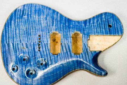

To you experienced guitar finishers...
I am at the tail end of my first two electrics that I have been building side by side for the last year and a half.   I have done and redone everything.  Currently, I am about to wet sand and buff the finishes (I used KTM9 sprayed and leveled 5 'wet' coats per day, 3 days - heat drying for 11 days - can't wait any longer because I want to get these into the hands for whom I have been making them...) and I do not want to mess them up.
The main question is: I have a sag and a run between the two guitars, how do you go about leveling those aweful things without jeopardizing the remaining finish?
Hesh - Though you know it or not, Lance used you and your bathroom shop to convince me to put a shop in my closet - all 38x78" of it, in which I have done most of the work on these guitars...so thanks...
Anyway, here is a shot of one of the dyed tops, which I really do not want to mess up.  If I sand through, it will catastrophically ruin my life forever.
Any advice born of experience would be immensely appreciated.

    Your finish appears to have brush strokes in the reflection that runs down
into the pot holes Why is that texture present? After wetsanding, it should
be very smooth. Jus wondering.
     Nice body shape and color, by the way.

The razor blade scraping technique worked like a dream...The finish then leveled very well.  Thanks so much guys.
Kevin, The shown in the picture is only the epoxy precoat, before I leveled that.  I just wanted to show a picture of what I was working with.
Stephen
