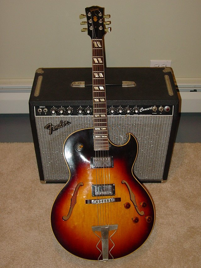

At some point finish cracks are like old friends. For example, my 1960 ES175D:
