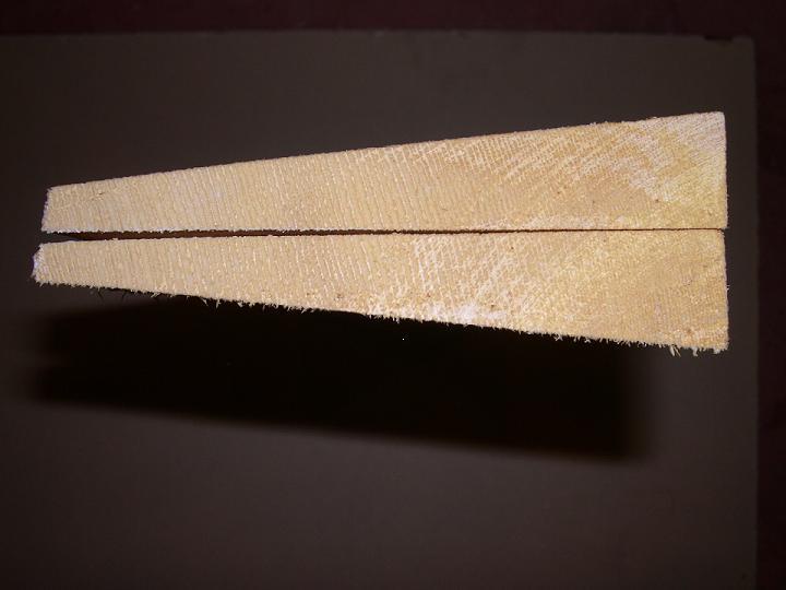

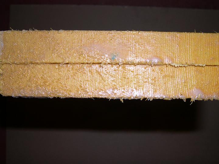

Wedge cut wood:
Dimensional:
Once carved I see very little difference between the two cuts if well quartered.
Michael Lloyd
