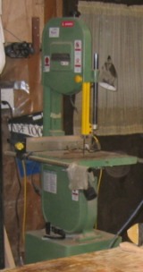

I've got an 18" Jet bandsaw. If it was stolen I'd get another one just like it, and maybe put out a hit on the guy who stole the first one.
