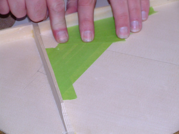

I thought I post a tutorial on the way I fit a bridge patch as I'm sure it's differnt than most if not all. I like to do it after the X's are glued on vs. prior like most others.

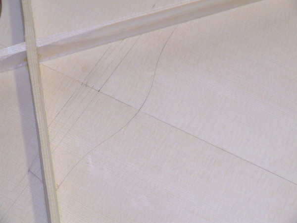

I start with a very accurate layout just like other methods.
I the install the X's and tape up the area with one layer of masking tape like so and trim the tape to the X's
I then lay down a couple of other layers of tape in different direction to help hold the whole thing together.

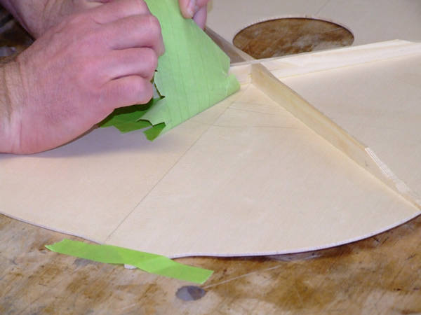

I like a large radius on my bridge patches so I draw it on now using a beam compass.

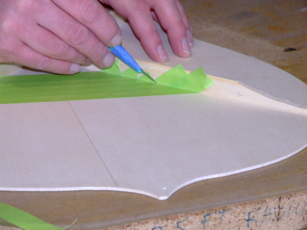

I then care fully peel and trim the tape to the shape of the bridge patch.

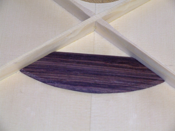

Tape the trimed pattern down to your material. I like cut off from rosewood backs myself.
Cut to size carefully and you have a nice fitting patch just in the right spot.

I see that you orient the grain of the bridge patch perpendicular to the top.  I have been considering turning the grain 90 degrees, the logic being that it will be more resistant to cracking from the pull of the strings as well as more in sync with the movement of the top.  Any opinions?
PostPosted: Sun Apr 29, 2007 3:07 pm
Posts: 2997
I haven't had any problem that I know of in the 10+ years of orienting them this way. My string aren't in line with the grain however for this reason.
I think some may orient the grain at abouth 30 or so and that makes alot of sense to me. I just always forget to do it when I make these. maybe next time I'll try that, if I remember.
I don't think I'd go 90 degrees though. You'd sacrafice alot of cross grain stiffness.

Do you find any advantage of a curved BP over a straight one?
PostPosted: Sun Apr 29, 2007 11:39 pm
Good tutorial Jim. Thats a good way to get a perfect fit against your X. Thanks much !
PostPosted: Mon Apr 30, 2007 3:45 am
Posts: 2997
JJ, I like a large bridge patch to help counter the torque of the bridge over time. The radius helps me to keep the weight down on it. I also thin out my bridge patch at the front and back.

May I ask, do you notch under the X braces to allow the bridge plate to go under them a bit?
Robert
PostPosted: Tue May 01, 2007 2:24 am
Posts: 2997
Robert,
I don't notch the the bridge plate under the X. I just fit tight up against it.

PostPosted: Tue May 01, 2007 2:34 pm
Great tutorial!!!
I do run the grain on my patches totally 90 degrees...I can see both points but it makes a lot more sense to me to run it at 90 degrees.
