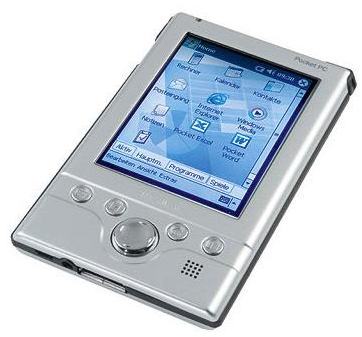

If I were going to approach this project I’d cannibalize a pocket PC. Prime candidate? Toshiba e series. The e330 can be picked up for 50 bucks or less on ebay.
It measures about 3 x 5 inches and is about ?-inch thick. It weighs less than 6 ounces, gets about 5 to 6 hours on a fully charged battery. It has enough processing horsepower that it could run your effects, provide a drum machine and display your set list all at the same time. It uses SD memory cards, so storage is no problem. The OS is Windows PC 2000, (same as Windows CE 3.0)
I have one of these and use it much more than I thought I would.
