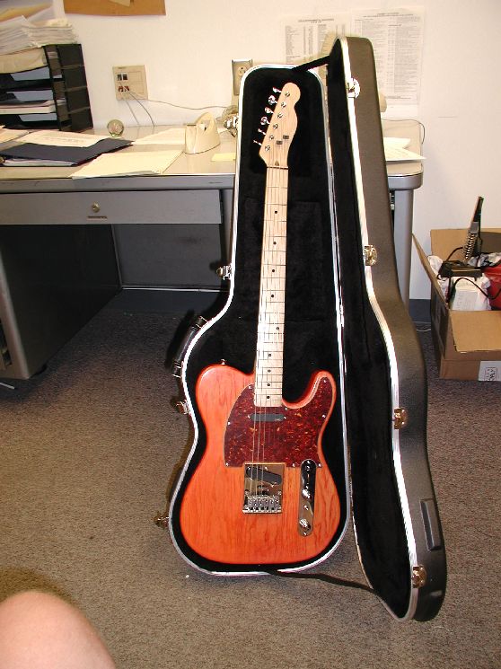

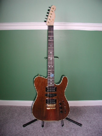

My first, finished, six years ago, and second, 5 years ago.
