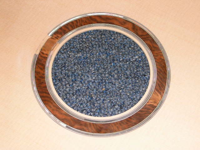

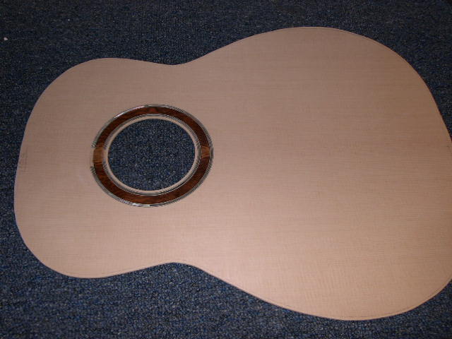

This guitar is finally moving forward.
I've posted pics earlier of the b&s wood, but here's a shot of the rosette installed.
It's a piece of the extra fabulous Taz Tiger Myrtle supplied by Tim Spittle, let into a top of Lutz supplied by Shane. It's bordered inside and out by some pale red ab, which shows up rather dark in the poor light.
Thanks for looking.

Thanks guys!
No worries, there will be no black paint near this guitar.
And not because I dislike black paint. (That's for you, Hesh. )
I'm a little disappointed in the red ab. I thought that some colorful paua would compete with the myrtle. So I opted for the pale red ab. It was perfect before inlaying. After leveling (slightly) the pink hues turned green/blue/silver. But maybe it will--indeed--not compete too much with the figured wood?
We'll see. Anyway, many thanks for the impetus to keep going.

I really like your rosette! Looks very good! What width is the ab? Did you cut it yourself or buy it in curved pieces?

Oh, that is really lovely! I am using some red abablone for the first time on a rosette that I'm making now, it won't be as elaborate as yours though. It is a beautiful material, I really like the warm hue in the colors.

Lovely rosette - I love the subtlety and "flow" in the tiger-myrtle, especially the light piece at the bottom. Was it bookmatched or cut from one piece? Maybe the ab will show better under finish.
I can see where you were coming from with the red idea, but I'm a sucker for black with that shade/pattern of wood (no need for Hesh's black paint - do your guitars suffer from rust Hesh?) and I think black shell or even black purflings rather than the white you used would be an interesting variation. Lots of guitars still to make and lots of new rosettes

Is this your first Lutz experience? I'd be interested in how you compare/contrast Lutz at this stage with other top woods you've used over the years.

Christian-- The red ab is 1/16" width purchased from Andy DePaul. It was cut to a 4.9-ish radius, neither of which my circles are. It does "bend" a bit, as you can see.

Dave-- yes, the material was bookmatched, and the lightest part oriented toward the join, then kept on the top's centerline. And yes, the Lutz is great stuff.

JJ-- where you been?? But yes, this is my first time working with Lutz. It is of course paler than Sitka, and it's also lighter in weight. It is not quite as stiff as the Sitka I've been using, so it seems to compare--so far--to Engelmann in its properties. However, it's got Engelmann beat in the "looks" department. I'll write more later when I get this baby done.

Steve, that looks great. As Hesh wrote, I'm seeing a silver-like effect, too. I like it, and I think you will too, as time goes on. Disappointment is a normal first reaction when something doesn't turn out as planned. I think it'll look superb if you are planning some toner in the top finish.

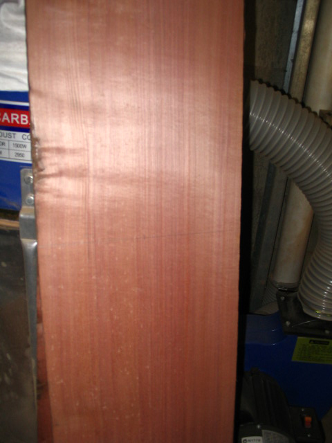

I just bought a couple of planks of "un-tigered" myrtle.
Here's a very dodgy pic. (the spots are MDF I was flinging around the shed )
Having grown up in Tassie, Myrtle was generally used for parquetry dance floors and high quality kitchens.

Carlton, No top toner. However, the red ab will be used for purfling top and back. And why not? Since this thing is over the top already, might as well keep going. And if it ends up looking like a Faberge egg, well, maybe someone will want to steal it?

What I like about the combination of the pale red ab and the tiger myrtle is that the shell doesn't overpower the myrtle. The myrtle will darken under finish quite a bit, and the shell will pop a bit more. The two will not fight for attention, and the overall look is going to be (and is) classy.
Nice work...as usual.
