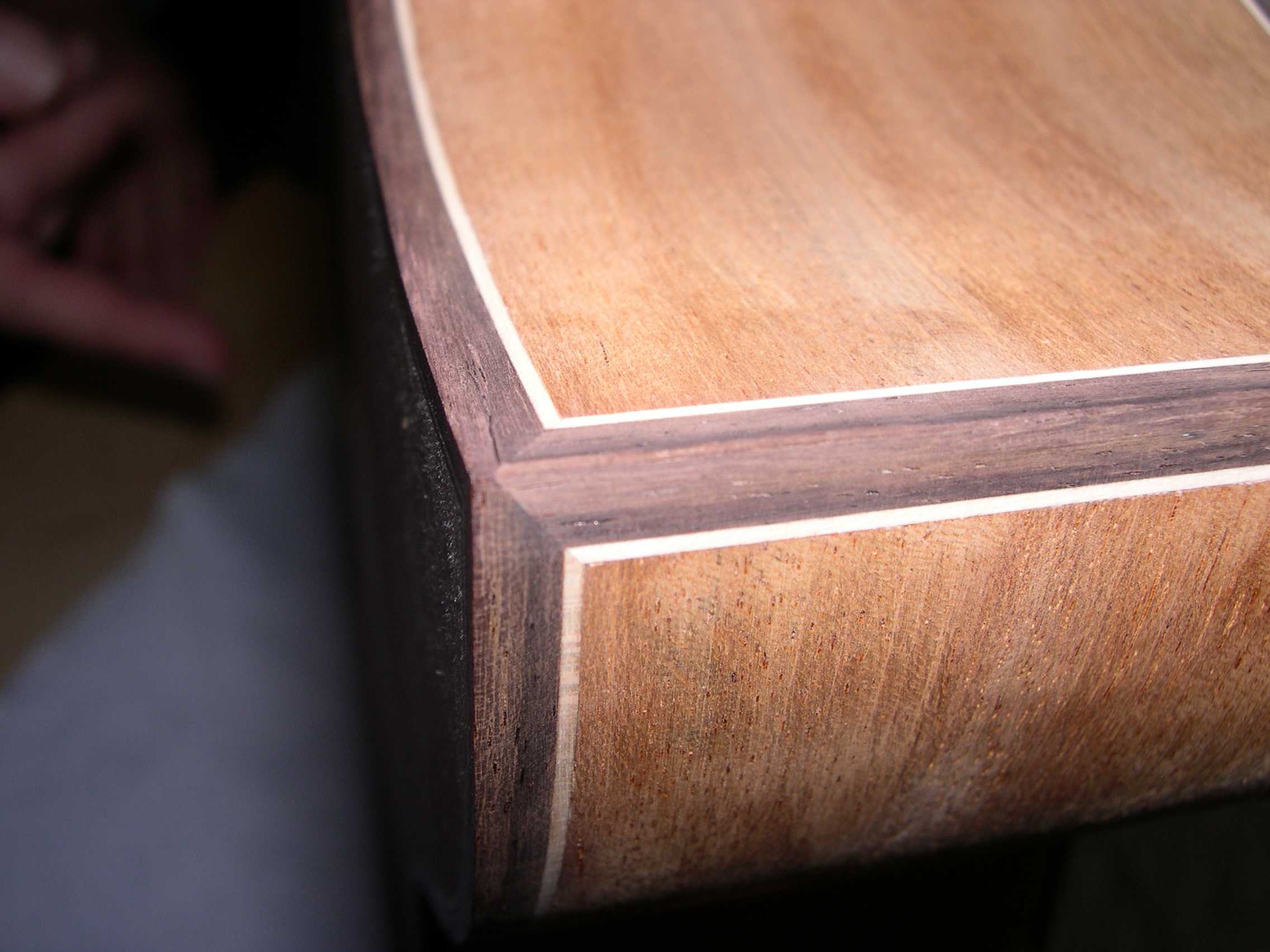

I bound the soundboard first and got a good miter at the florentine junction . I then cut (with a chisel) an angle off it for the cross piece to fit. The cross piece angle was done on a disk sander ( and miter table ) . Next I bound the back and mitered the florentine junction . I cut the tip angle off to receive the cross piece of binding/purfling , (like I did the top) Now ,, here's the big tip ! I made another cross piece , identical to the one I was to fit on .( but shorter so it would easily trial fit between the top and back bindings) . With this spare piece I adjusted it's (compound ) angle on the disk sander until I got a perfect fit with the binding ( AND SIDE PURFLING ) . Having the disk sander now set to the correct angle , I then disk sanded the cross piece I am to use .
I'm trying to post a pic but it won't do it at the moment . Will try again shortly.

Hope this helps ,and you understood my process. There may be another way of doing it ! just couldn't think of one . Sure was tricky . An unmitered cross piece would be a whole lot easier !

OOOPPS , Sorry guys , didn't realise the pic was so big.
Can't edit it either !!!
Didn't really want that much of a close up on my miters
CRAIG LAWRENCE of AUSTRALIA

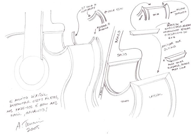

Posts: 1969
Here is another way.
