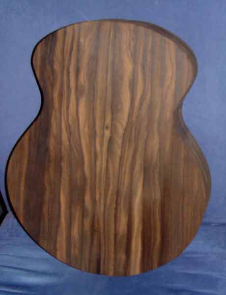

I think you have just gotten a particularly stubborn piece of ziricote. Here is a pic of one I have underway, and it bent fairly easily. I was more worried about getting the longitudinal arch (my boxes are deepest under the bridge) of the back happening without it cracking, but so far, so good.... (fingers crossed).
Now for some of Bob's bloodwood to wrap it in.... russ38404.6123958333
