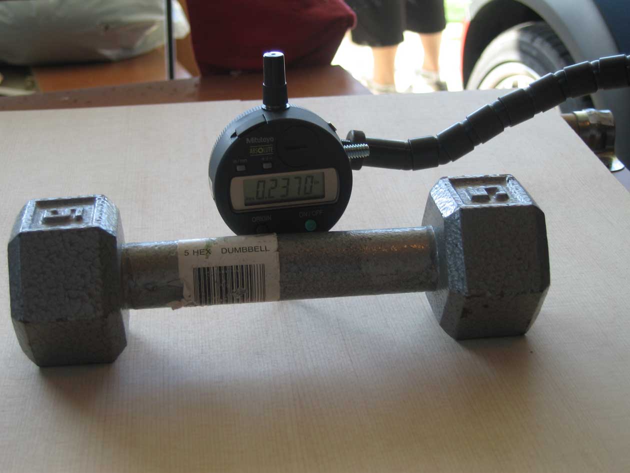

More points. The advantage to deflection testing is you can get some hard data with regard to stiffness. Each piece of wood is unique and should be treated accordingly.
Why thickness each top to the same thickness???? My analytical brain thinks that is rediculous. I have felt many pieces of wood of the same type that were DRASTICALLY different in stiffness. If you thicknessed all of them the same and made guitars with them, they would all be different.   Also each body size changes everything. A smaller body guitar is different from a dreadnaught.
My set up is just a table with 2 bars and a dial indicator.
Simple as that!!!! I just put a dumbbell on it.

Is that only the cross-grain stiffness that you measure (as in your pic), or does longitudinal stiffness come into it too?
Seeing as most of the tension from the strings is acting against the longitudinal stiffness (or so it seems to me). Then the X brace, tone bar(s) and finger braces help to stiffen up the cross grain stiffness of the top, and by carving them, give some control over cross grain stiffness (and I guess the X braces are going to contribute to longitudinal stiffness too).
Seems to me; that might be where people are coming from when they say you can thin the tops a lot more than most of us do. Get the longitudinal stiffness right where you want it, and you have cross grain stiffness adjustment through brace carving.
