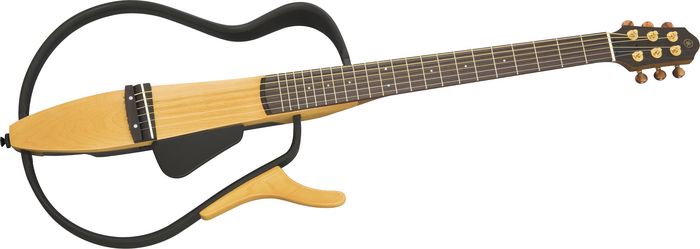

I'm looking to build a travel guitar. I can't take a chance trying to take one on the plane. So, I'm not thrilled with this guitar, but thought I would build my own version. Has anyone out there built anything like this?

The problam I can see with the one pictured is that it's too long for most carry-ons.

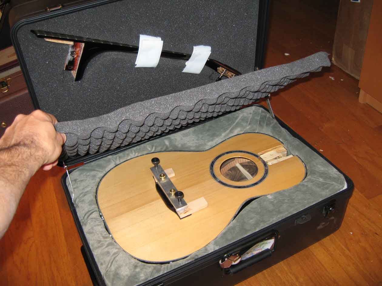

I built a travel guitar. Basically is was a Martin O parlor. A real guitar.
I typically attach my necks with a dual tenon (Mayes Bourgois etc)
All I do when I travel is attach a few capos, remove the bridge pins, remove
the neck and place the guitar in my napsack!!!!
I just carry it on a plane.
Easy for a luthier to travel with. Might not be for the average guitar player,
I also have a hardshell case for it as well

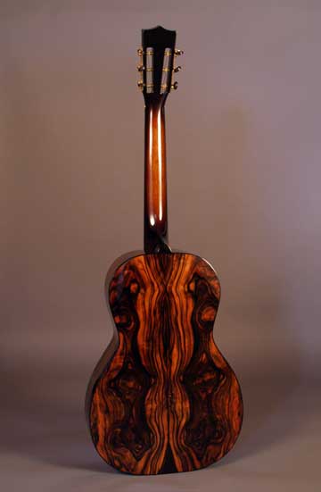

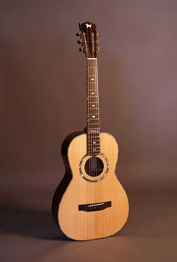

Here are picts of my travel guitar

The irony about your comment is I just chopped off the top of this one!!!!!!
I love the look of the guitar, but I didn't like the sound. Experience has lead
me down a path to improve the tone!!!! I am going to put a new lighter top
on it, Lutz this time. (This one was port orford cedar) It will end up looking
the same, but hopefully a tone that matches the look.
Mark sorry for the highjack. Search the net for other travel guitars. But a
real guitar is so much better. Just build a nice parlor with a removable neck.

This guitar is easy to travel with. I can put it in the hardshell case and bring
it on, or place it in my backpack and bring it on.
Realistically it takes me about 2-5 minutes to brake it down and set it up.
