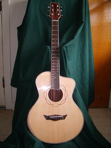

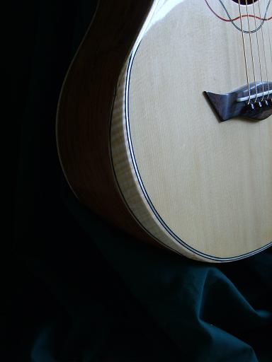

Here is #7, I built this one in conjunction with #6. It was built for a LINT show coming up in October, so I busted out all the stops. The body shape is my original design, and is based on a sort of mini jumbo shape. It is only 14.5" at the lower bout. I used parabolic bracing, again. I am extremely pleased with the sound. excellent balance, and I am surprised I was able to get the basses to come through given the small body and the armrest.
Specs:

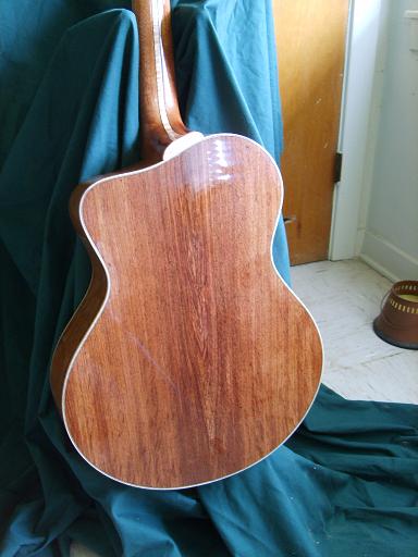

Back and sides: Honduran RW
Top: Sitka
Neck: Mahog/Maple/Mohog laminated
Fretboard: Ziricote
Bridge: Ziricote w/ snakewood pins
Binding, endgraft, arm rest: Flame maple

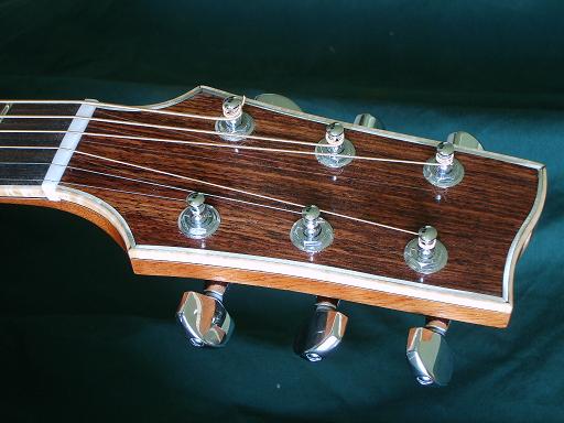

Peghead veneer: Honduran RW
Purfling: Sterling silver
Fret markers: Paua dots
Finish: Epoxy/ Mcfadden Sealer/Mcfadden Gloss
Scalel: 24.8
Enjoy

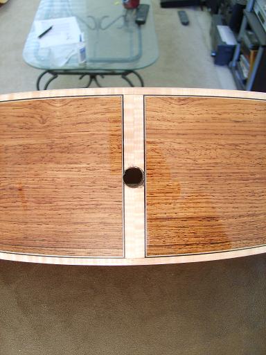

Hesh- please don't CSI/image enhance this one, it scared me last time , also the end pin is drilled for a B-band which I don't have yet.

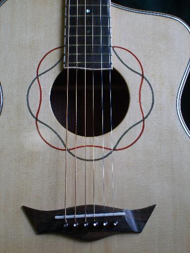

Very nice Matt. Brother Steve is going to have to pay attention with this one around. How did you do that rosette?
PostPosted: Mon Apr 23, 2007 12:44 pm
REally, really nice guitar, Matt. That rosette is striking.

And Matt, I don't say this lightly--that's a stunning guitar! Clever rosette, beautifully executed, and what looks to be a flawless finish.

How does the HRW sound? Also how was it to work with?
I have a set I bought from Hibdon about three years ago and am just starting this week. Enquirirng. minds want to know.

I don't know about flawless, look at the 2nd photo at how badly the heel has warped.
You did a fine job of fitting that heel, Matt.

Turned out really nice Matt J. The armrest looks very nice. When is this next LINT SHOOTOUT?

Very Very Cool
One of the best rosettes I have ever seen!!!!!

Second, I'll address the rosette. Maybe I'll do a Hesh inspired tutorial someday. I have a pattern made of 1/4" plywood, it's shape has 4 "lugs" which correspond to each peak and valley on the wave. There is a hole drilled in the center for a pivot point. I also have dremel with a modified base with a patern guide in it. I follow the pattern with the dremel, then rotate it 45 deg or whatever pattern I'm going for. I inlay the b/w/b purfling strip, and then inlay colored epoxy. I'll come back later with a pic of the template.
Hesh: I hate to say it but I've never played, or heard, a BRW guitar played . But I will say HRW has great projection, and a very bright tone.
Chris V: to get it to fit is mostly file, sand, file, sand, and the old sandpaper strip trick. the problem with this one was I continued the curve through the heel. next time I think I'll leave that area flat, it shoud make fitting a lot easier.

Impressive, creative work Matt! That heel join is a jaw-dropper.
