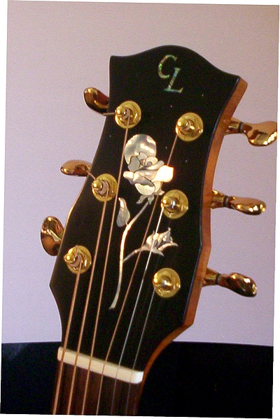

With my first inlay ( below ) , I lay all the pieces of the rose together on some double sided tape . I then piled ebony dust over it and worked it between all the pieces , leaving a small pile above level. I then hit it with C.A. . Once set , I peeled of the double sided tape ( very carefully) and trimmed off any excess C.A. and dust from the perimeter of the rose ,or in your case ,the sun . I gingerly glued it to my headstock , and scribed the outline. I very carefully slipped a razor blade underneath to release it .
It all came out O.K , and even Mr. Lavin gave it his approval !! Yoo Hoo
