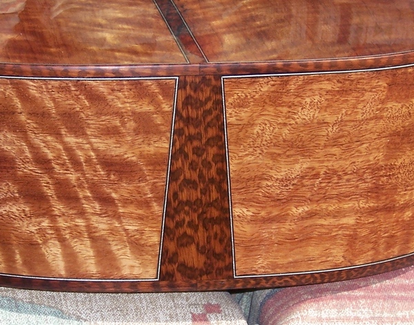

I have seen some beautiful curved ones too.. I think it was Paul Woolson

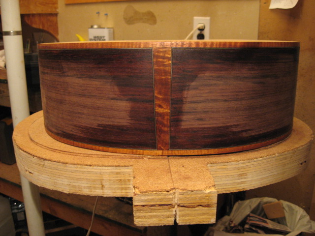

FWIW...Here is one I did.

I would have thought straight ones would be more difficult to fit accurately (whereas slightly angled ones can be wedged in so the seam is always perfect - assuming the graft & pocket angles are the same). No?

Dave, that is probably true. Another advantage of the wedge is that if the top and back center seams don't exactly match up it will be less noticeable if you use a wedge. I use both straight and angled ones depending on how accurate I have been up to that point...
FWIW, I use only a sharp knife to score the lines, a small saw and chisels to take out the waste. I'm sure it would take me a lot longer to set up a jig, fiddle with routers and bits and so on, than just cut it with some simple tools. Unless you have everything set up and ready to go, as in a factory situation, or you plan to do something very elaborate, I don't really see the point in a jig for this.

Thanks all for the beautiful end grafts.  Paul, could I suggest you show this beautiful end graft on your site?  I went to your site because of your reputation but did not see pics of your end grafts.

You guys keep setting "the bar" higher and higher !
I had never even thought of doing curved end grafts, but seeing Paul's curves gives me a new direction to try with the next guitar.
GREAT job!

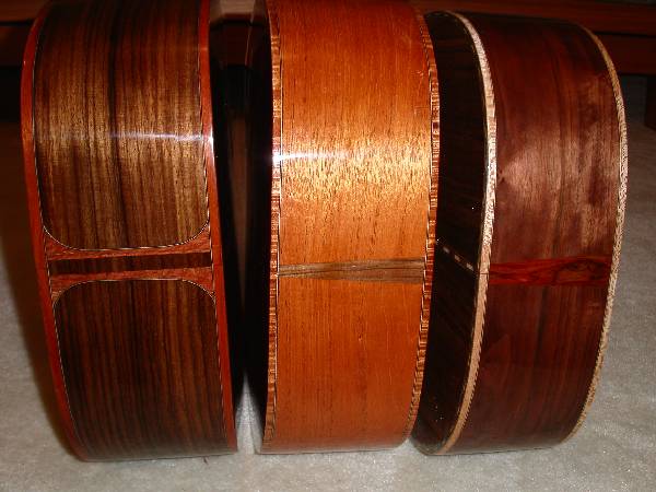

Here's the last 3 I did.

Graft is alive at the OLF! Nice job guys.

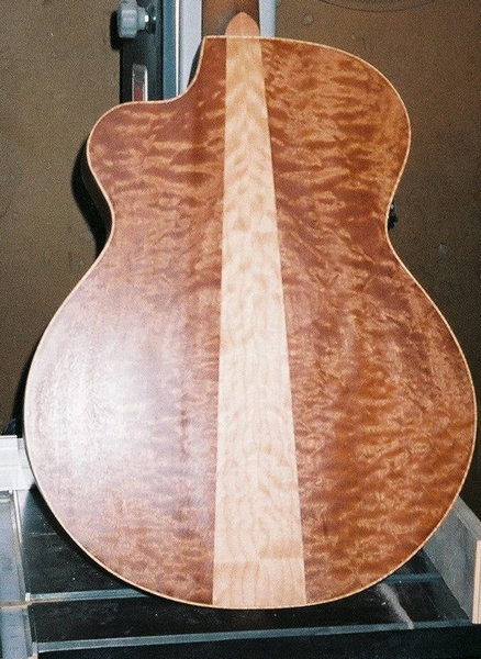

Oh!! You said angle of end grafts My bad
This might work better

Somebody needs to teach Paul and Greg how to do a tapered end graft.
