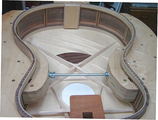

            With my current 12 string project I have elected a 24.9 scale . A bit less tension and a slight ease in playing considering the wider neck.
A 13 fretter, Which I'm hoping will be a little less leverage on the neck , but more importantly ,place the bridge back to a better part of the soundboard .
I've also used an Englemann top . I'm hoping to lesson the 'jangle' with an Englemann tone.
My bracing is very light , but still incorperated the third lower tone bar , although it is really small ( 6m.m. in hieght ).
Also I have included a Lowden type A-Frame to help cope with the extra string tension . Hope this helps.
Cheers Craig

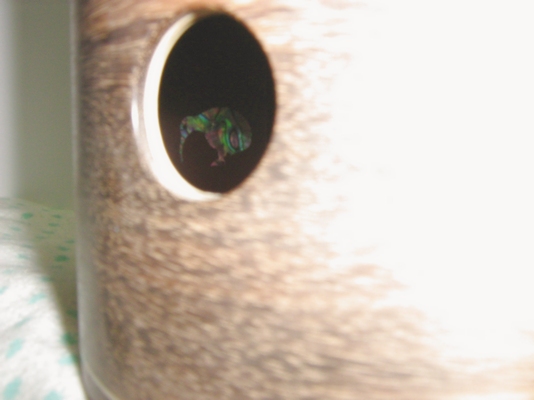

I also have a soundport !! The little Paua Kiwi is inlaid into the headblock.
CRAIG LAWRENCE of AUSTRALIA

That looks great. The light bracing will work very well I think.
