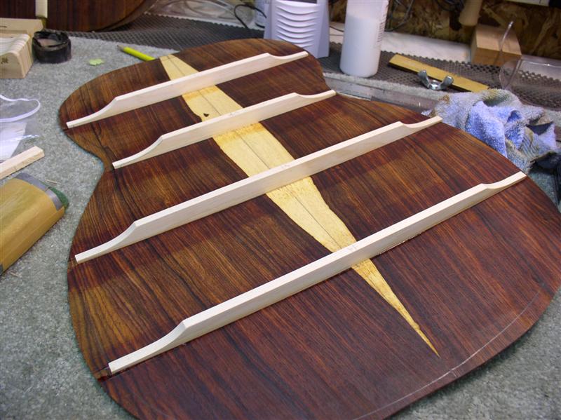

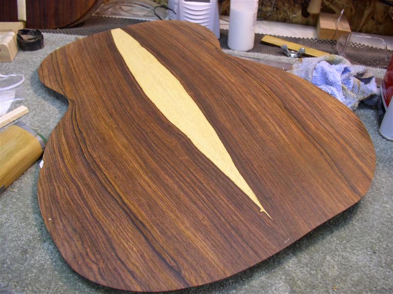

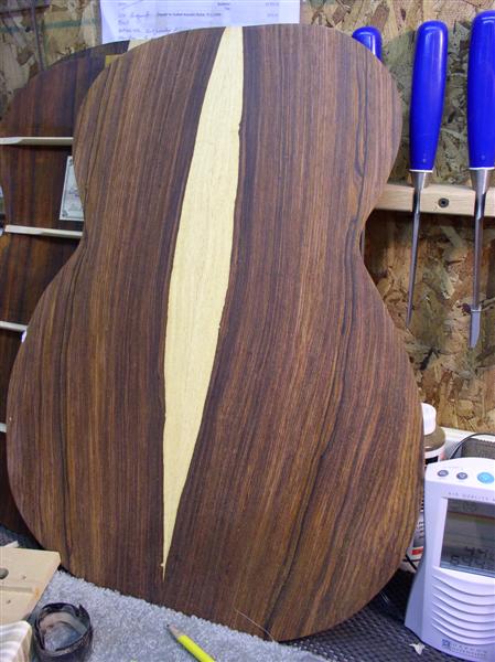

So, I was on the hunt for some more Coco. Brock Poling came up with a fantastic replacement set for me. My customer specified a sapwood center strip, that is indeed what we got. Here are some current progress shots. With a little luck, I should be back on track by this weekend.
The timing is bad, since HGF is approaching fast, but I really had no alternative, this one has to take priority, and son-of-gun if it ain't fighting me all the way!
New back with sapwood

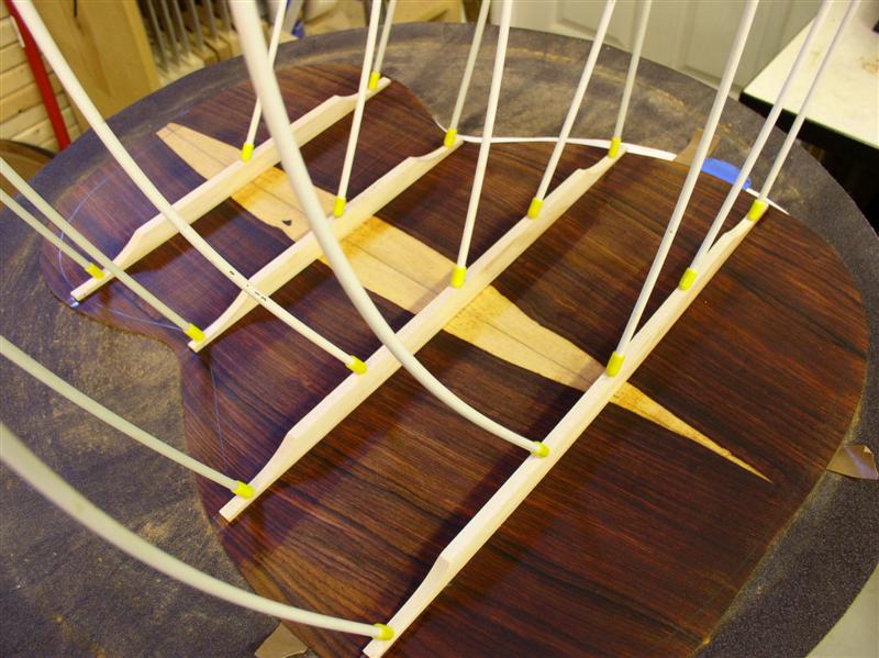

Braces glued on with epoxy,

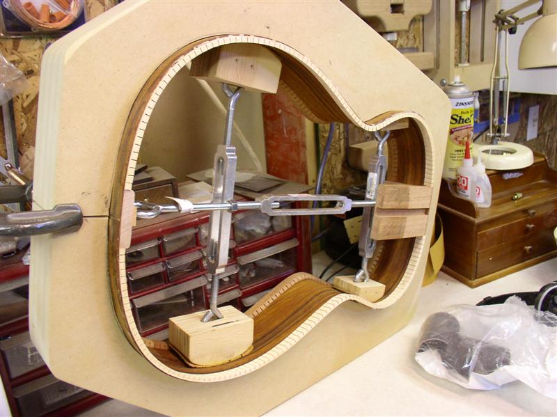

New OMFS mold with new side set.
I managed to knock this set of rims and the back out in a weekend + a day, that is a record for me! Its what can happen if the KIDS leave me along

Lance, I really like your set up! I’m gonna have to get, or make a mold one of these days.
That coco back looks outstanding, and I love the sapwood center strip!
Curious though, why reverse kerfing on one edge but, not the other?
Also, I’ve not seen braces shaped like that before, could be just me, seeing something in the
pictures not exactly right, but, they do look a little beefy. I’m sure you planned it that way for a
reason. Just wondering!
Robert
PostPosted: Tue Apr 17, 2007 5:14 am
Robert,
the braces are beefy right now, I glue them on full width and profile them after there dry, but before I put the center strip in.

Looking good Lance, that certainly is a very nice bit of Coco.
PostPosted: Tue Apr 17, 2007 10:53 am
Lance, Looks good but that wide sapwood,I don't care for myself.I don't mind a small strip in the center but this is too much IMHO. Good luck with the rest of this build,I hope it goes smoothly for you.
PostPosted: Tue Apr 17, 2007 11:51 am
Dave, I totaly know where your coming from, but for me, the more the merrier!

I would be nervous about that sapwood. Seen it check too many times.

Very nice wood selection...I like the sapwood.. I sincerely hope things go better for the remainder of the instrument. I hate when *crap* like that happens. It can kill your motivation.

Your new coco looks great and I will wager the customer is getting a prettier instrument for all of this.
