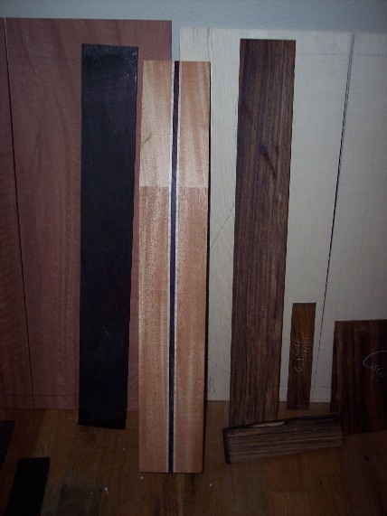

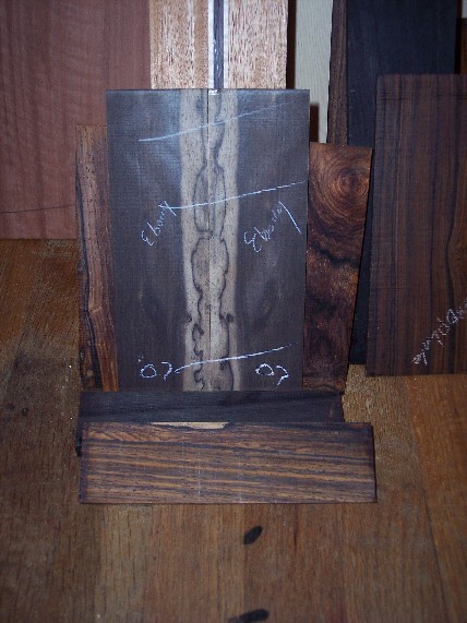

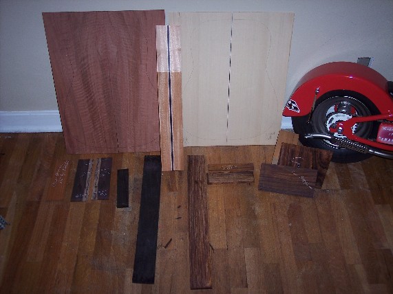

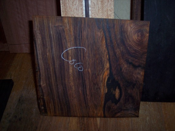

I received my all my zoot today!!! Bob from RC Tonewoods has been very helpful so far. Thanks Bob! This is my first guitar, and as you can see from the pics I purchased both ebony and cocobolo fingerboard, bridge, headplate. I did this because I couldn't make up my mind of course. Plus I'll have a headstart on #2 in six or so months.
I really love the laminated neck, and the coco rosette blank has a lot of figure which is nice.

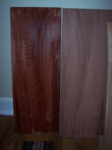

Well I am also posting this with my tail between my legs... I may have already made my first newbie mistake. I decided to lightly wet one side of the back for a picture... it started cupping in a matter of seconds. I immediately put it on some MDF with a weight on it. I used very little water and I don't think it is that bad. I did a little reading and it looks like I probably should "sticker" it. Or is there any other suggestions before I do this? I believe the back and sides are already sanded down to .085 if that helps. Thanks all!!

Craig,
Your back will probably be fine by morning, just leave it flat on your bench, wet side up. They are so thin that they dry quite fast and should return to normal soon. You will want to aclimate the woods to your shop envirnment for a week or two minimum anyway. The back is probably thicker than .085 otherwise you are going to have to be VERY careful about joining the plates together as you have almost no room to clean the centre seam up after gluing.
Good Luck!
PostPosted: Mon Apr 16, 2007 6:56 pm
Christian like Shane stated above they should be fine. I believe the backs are around .120-.125 and sides are .085
Keep the backs sickered untill your ready to build.

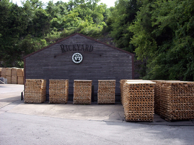

Thanks for the pics and explanation Hesh! Stickering is like what I saw them do at the Jack Daniels distillery in good ol' Lynchburg.

ive seen commercially made "stickers" made of some sort of composite i think, but i was wondering what a good wood or other material would be to use for this purpose. so what do you guys use?
