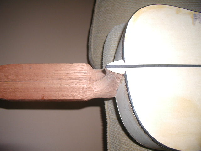

I'm working on a pair of flamenco guitars. The bodies are Alaskan Yellow Cedar, with ebony bindings. I'm trying to do binding details equivalent to the included picture cribbed from LMII. Luckily, one of the guitars is for me, and my knife technique is improving and hopefully will be cleaner for the second.

That's a pretty challenging binding detail in the picture from LMI. However, you can take heart in the fact that you will probably get your back inlay strip centered on the heel, unlike the example in the picture! This kind of stuff is all too 'high-risk' for me now- and my hat is off to anybody who tries it.

John - I wasn't going to say anything, but I was surprised that someone would pick that particular picture to showcase their work - I've been particularly careful to get my back strips centered on the heel.
I'll swallow my pride and exhibit the first of two attempts. I'm not real happy with how the bass side looks, but it's worse than the final will be here since nothing is sanded out yet.

Your work looks pretty good to me, Jim. I have a convenient 'rule' I use in such situations: "Anybody who would re-do this job is just obsessive about details, and needs therapy." It works for me!
You just have to take a look at some older instruments a few times to realize that the standards for 'neatness' have risen a lot.

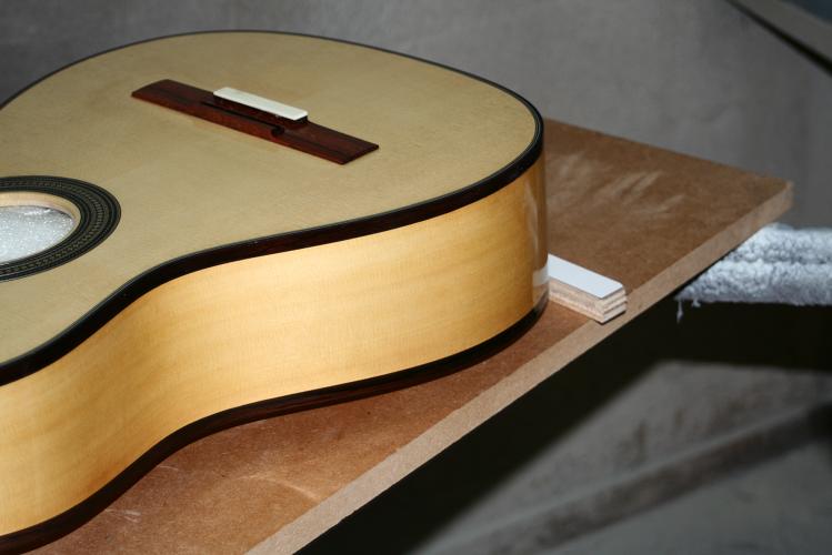

i did two flamenco guitars with yellow cedar and dark binding(in my case madagascar rosewood).
and it really all cleaned up nicely once "finish" sanded.
Cumpiano once said that he never sands using a grit finer than 220, that way the binding's 'wood dust particles' arent small enough to go deep inside the pores of most 'guitar woods'.
and that way he avoids the problem of 'staining'.
