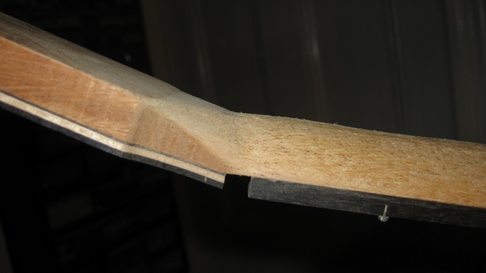

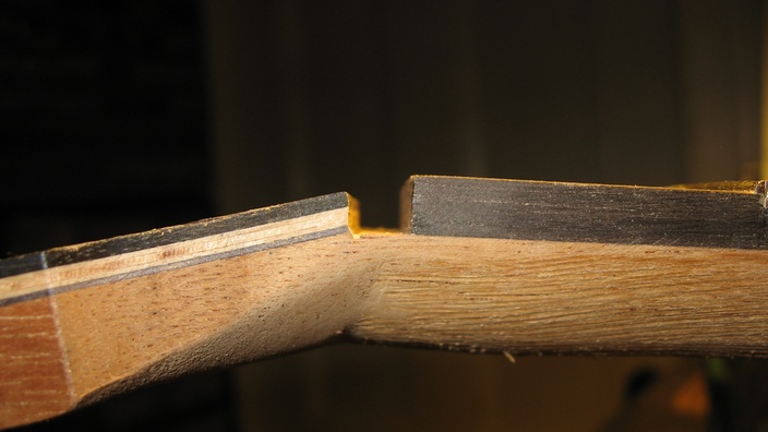

Thanks alot. This gives me confidence. My truss rods are .437" as well. Here are a couple pics if anyone thinks it might help them advise me. The neck is attached and the truss rod already installed, so the Carbon Fiber thing may only help in the future
PostPosted: Wed Apr 18, 2007 10:47 am
Posts: 1055
Hi Kevin,
Looking at the photo youve got about the same thickness at the nut as I have on my steel strings...possibly a bit more. Looks ok IMO.
Cheers Martin
PS welcome to the forum!
