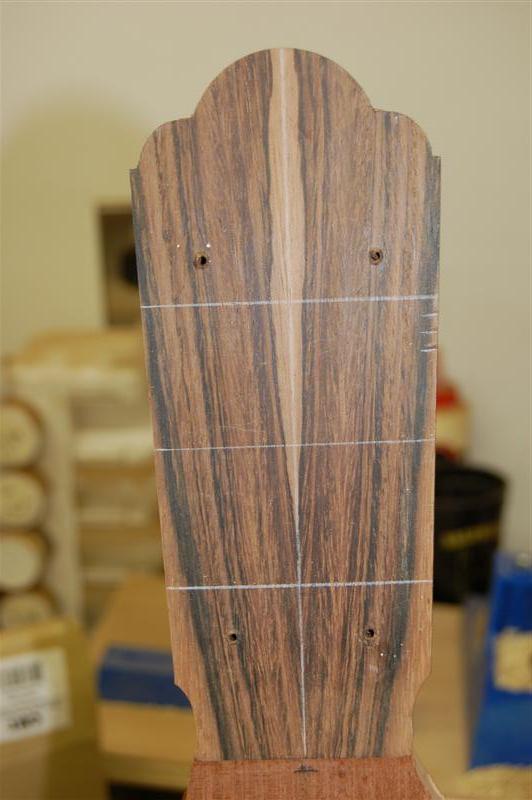

The first step is to drill the tuning machine holes.

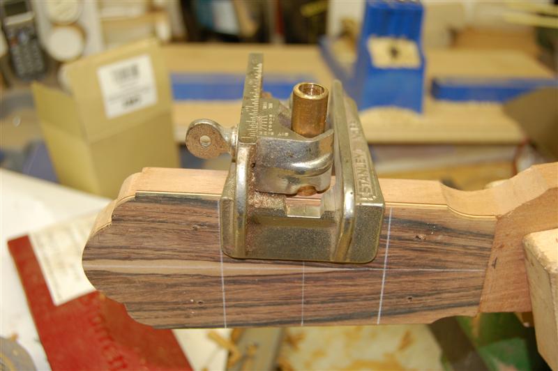

I first mark the centers out on one side and then transfer the holes to the other side by drawing perpendicular lines across the head:

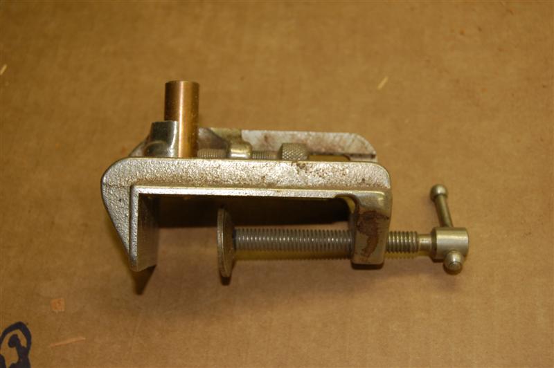

Next,I use a Stanley doweling jig to drill the holes:
Notice that the drill bushing is a piece of brass plumbing pipe.You need to custom make a bushing in order to get the exact size drill bit for the tuning machines.
I mark the bit with tape in order to stop at the correct depth.
Then I simply line up the index mark on the jig with my reference lines and drill the holes:

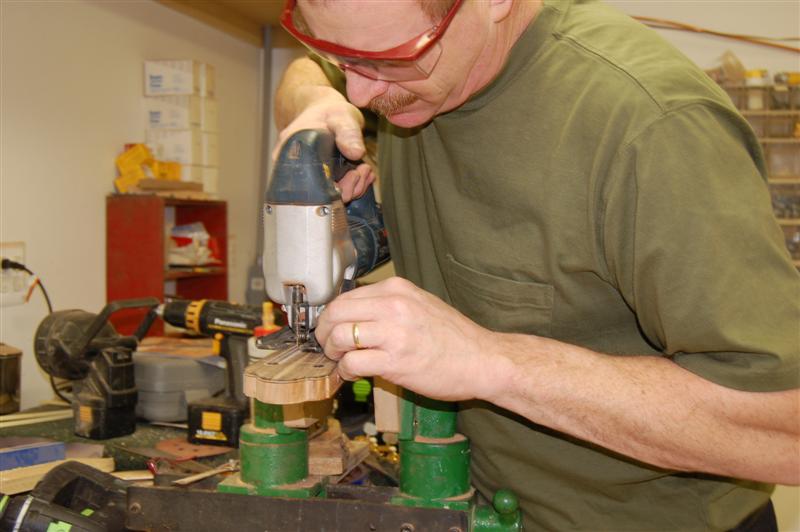

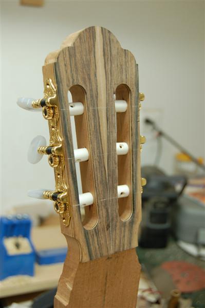

Next, I mark the slots and cut out the bulk of the wood with a jig saw:

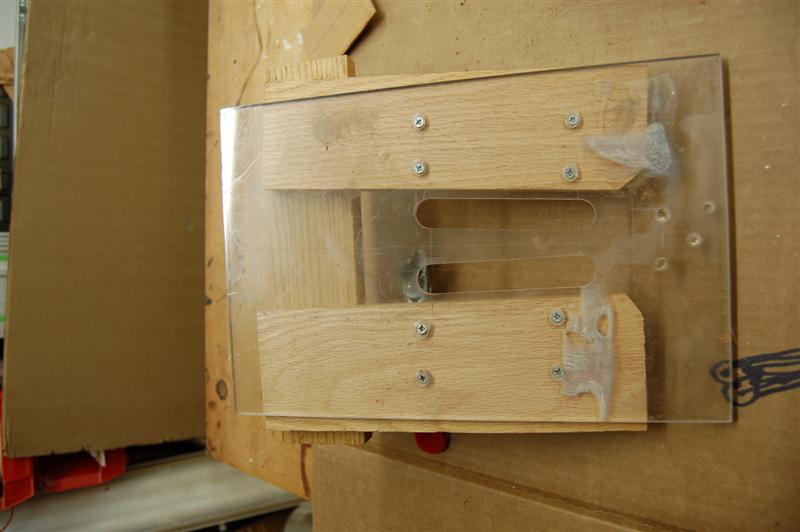

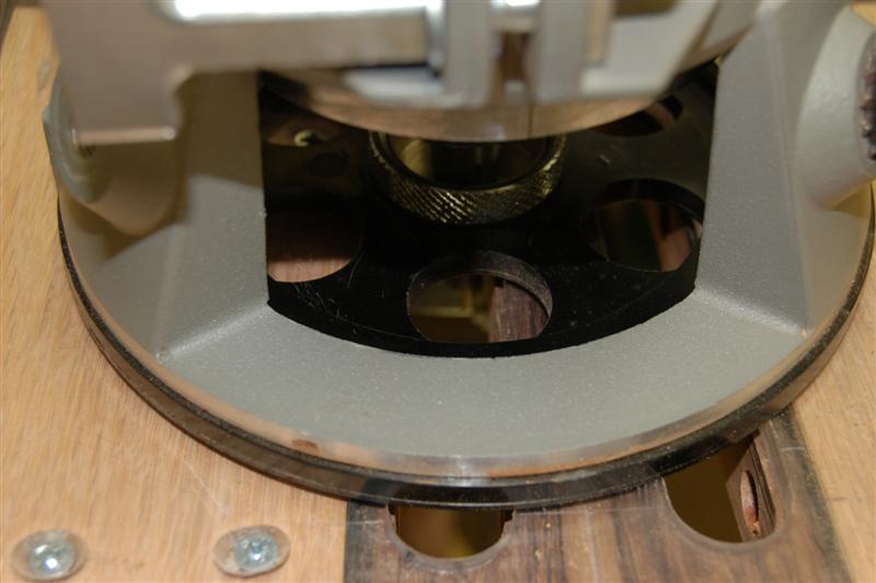

Here's the jig:

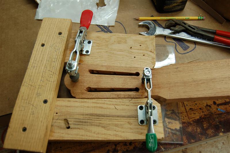

I clamp it to the head:

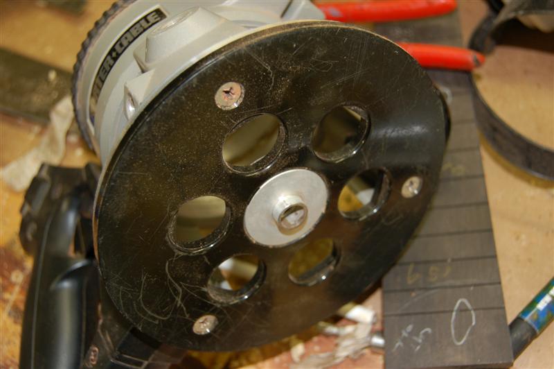

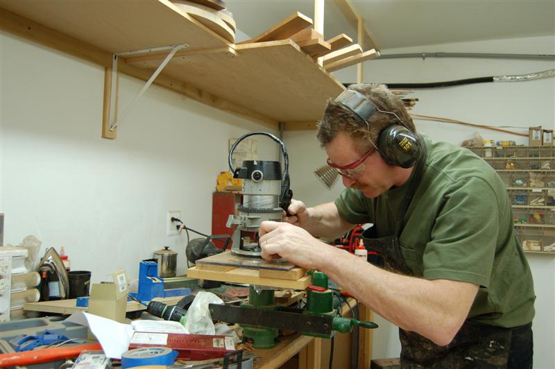

I then install the proper bushing on the router base-notice that I write down the size of the router bit and bushing on the jig for future reference.(I think the last time I used this jig was 4 years ago!)
I route the slot in 3 passes. A plunge router would be better for this,but I don't have one (yet!-I have every other tool known to man though!).

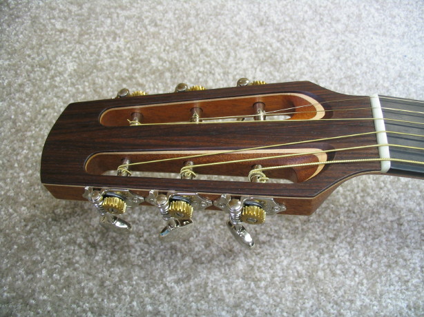

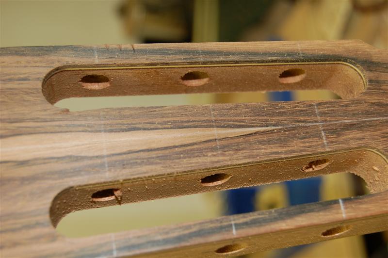

Here are the finished slots-all they need is a little clean up with some fine sandpaper.

AWESOME Brad! I am gonna have to get one of those Stanley jigs. They look like the cat's pajamahs!

My Stanley doweling jig is at least fifty years old-I think they still make the same one.

Super Brad!..Newbe question..Is there a reason for using the Jig saw instead of just drilling the pilot holes, securing the template and routing away?...Cheers...beautiful head plate!!
oh... Do you adjust ( or shim)the Stanley drill guide to ensure you are drilling in straight and not perpendicular to the sides of the headstock which appear tapered  ....or does that even matter??
Great tutorial...I hope to be using a slotted headstock on the OM I trying to build...tI think they look so elegent..Thanks again!!

That's great Brad. That's an excellent way to secure the jig to the headstock.
I thought about it briefly when I cut mine. The clamps would have been in
the way of the router so I cut it with a copeing saw and chisel. I like that
much better! Very clean and fast. Thanks!
You could probably use a flush trim bit with a jig like that if the slots were
the finished size? If you could, show us how you do the ramps on the nut
end of the slot.

Irwin,
You can drill holes to hog out the bulk of the wood insted of using the jig saw. I just find it quicker,cleaner and easier to us the jig saw-less chance of splintering.
The drill jig assures that you are perpendicular to the edge of the head (not the centerline of the head).
David,
You certainly could use a flush bit,if you make the jig the same size,that's how I cut the head shape.
I don't have any pictures of making the ramps.
I put tape on the inside of the slots amd use a rat tail rasp and file and sandpaper-takes me about 15 minutes.

[QUOTE=ToddStock]
One idea to prevent any lap marks from the multiple passes... I use three wraps of blue tape around the guide and make two 3/8" deep cutting passes (no hogging out the waste first). Final pass is made after I strip the tape off the guide, which gives a nice, clean, full-depth cut to final dimensions even if a 7310 or other non-recentering laminate trimmer or router is used.
Great idea, Todd! Thanks!
