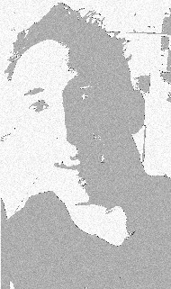

I'm not marquetry expert... haven't even attempted something like that actually. But I am always trying to figure out how things are done. I am a bit of computer geek too, so I figured I would just alter the photo in photoshop or something similar to bring out the lines. I guess I would just follow those lines after that. Here is a pic (me) that I did really quickly. This was just done on microsoft photo editor...
If I was a computer with a different photo editor, I could have isolated the 2 or 3 main colors like someone mentioned above. I also could have made it a solid black and solid white with more detail. But hey, this was just to give an idea.
Good luck! And post some more progress pics.

Oh... and do you have the original picture? That one looks like it has already been filtered with "watercolor" or something.
Christian

[QUOTE=Sam Price] .....Using a black and white zerox (photocopy) of this image and using that for reference is better, because of the contrast between light and shade is easier to pick out.
Good pint. I'll look into that. I was hoping to get wood close to his color, but I'm thinking a most simplistic approach would be better.
[QUOTE=Chansen] Oh... and do you have the original picture? That one looks like it has already been filtered with "watercolor" or something.
[/QUOTE] Good catch. Yes I do have the original. I was thinking watercolor would soften the image and allow me to choose wood easier.

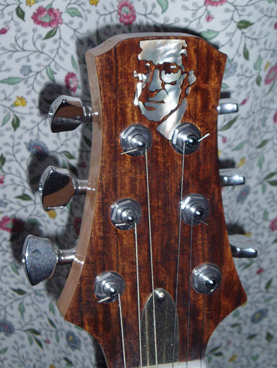

Check out this post thread from a while back. I saw this pic and figured it fit with what we were talking about. The link is HERE
Here is the pic because the thread is rather long.
I really think that this is the way to go. You could trace directly from the picture if you printed it like I showed above. You could still use wood, but just one type instead of many.
Christian

That looks nice Chansen. Steve, you might forward that photo along to the fella and see if it is acceptable to him. The variations in the shell give the face a nice three dimensional appearance. I like it!

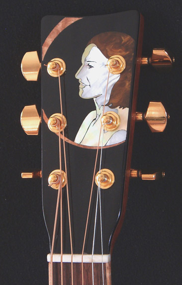

Hey, that's my inlay! I think that's the first time someone has "referenced"
my work on the forum. I'm honored! I actually went about that just like
Chansen did with his photo. I mainly use photoshop to get my inlay
pictures where I want them, or at least close. I often "desaturate" the
picture first, to get it black and white. Then I usually mess around with
the "posterize" filter until I see what I'm looking for. The one above is
certainly the easiest way to go, but was done a bit differently. Here's a
couple more with a bit more variation in material that might give you
some ideas, Steve, although I realize that none of them are marquetry.

Than you for posting this picture. I think you are right. I like it a lot.
Mike,
I really like this inlay and would like to do that in wood for my client. I think it is real classy.
