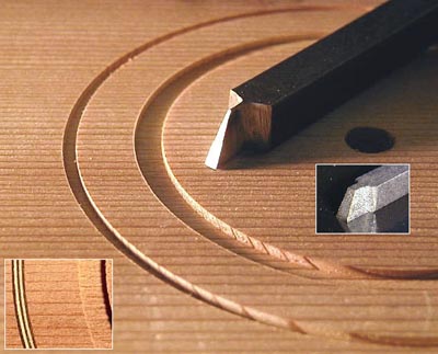

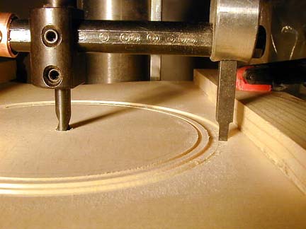

I've used a fly cutter with bits I ground myself. Shown are two bits I ground for the dimensions of a specific rosette.

I'm using the StewMac one, after years of aproaching the fly cutter on the drill press with a dry mouth. Part of the problem is my old drill press, on which the table is not perpendicular to the quill any more.

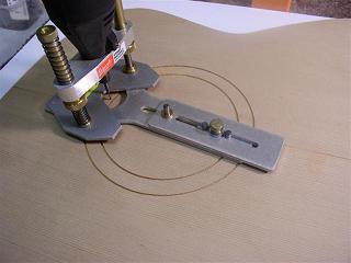

I have not seen a router unit that would work for rosettes. What Pete shows is the ideal set up but if you are like me and don't have a drill press with the required reach, I would recommend StewMac's P/N 5260 Dremel router base and P/N 0699 Sound-hole/Rosette Cutter Jig, (it requires the router base as an attachment). Be sure that your bearings in your Dremel are in good shape. The new pro series of Dremel's are suppose to have an improved bearing system. Remember any rotary tool is only as accurate as the bearing run-out and wobble allows it to be

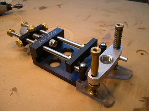

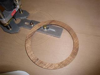

Here's what I'm using:
It's essentially the Stew-Mac dremel piece on a Micro-Fence base, it allows me to make channels with absolute control. The Stew-Mac circle cutter base is a bump adjust system, this is precise down to thousands of an inch. Very very useful, like Alan fly cutters scare me a bit and they are not very precise and your locked into the size of your cutter, I really feel this is the best solution that I've seen so far.
I have some info on my site here about it:
Rosette Article
-Paul-
-Paul-
Patriot Guitars
PostPosted: Wed Feb 16, 2005 2:08 pm
Paul that tool makes me drool.
I too use the Stewmac, and some home made setups using a dremel grout removal base cut perpendicular then epoxied into a 1/4 inch tempered hardboard base. After getting the Dremel attached then I determine my distance and drill pivot holes, three for a D28 rosette, I then go back with a dremel and a quarter inch cutter in the middle hole, that gives me all three rings. But Paul's has exactly what I found to be a drawback on the Stewmac tool, fine radii adjustment, the vertical adjustment is great.Dickey38399.9879050926

Paul---that's beautiful. And I bet it works, as an added bonus.

Posts: 886
Oh man does it ever work Steve, I did a bonehead move on a rosette and sanded through some of the inlay when I was sanding the top...
So I whipped this puppy out and cut out the inlay and trim and dropped new stuff in, I was actually shaving the trim out. I could have never done that with the Stew-Mac setup, I can also test fit and never go to far anymore, it's the one of the best tools in my shop
