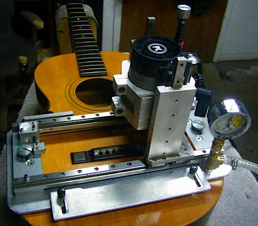

Ever since I saw Frank Ford's Precision Saddle Mill I have wanted to make
my own. I finally collected all the bits and pieces I needed and built my
own version of Frank's tool.
The mill slides back and forth on two linear bearings running on 5/8"
rails with stop collars to limit the cutting length. The up and down
motion is from a linear slide I picked up on EBay. I'm not sure what type
it is, but it was the right dimension for the project. The up and down
travel is about 1.5".
Here she is:
The red circle is the collar that limits the side to side motion.
The up and down motion and the cutting depth are adjusted up here.

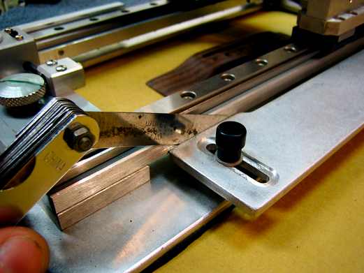

First, I made up this little step block.
I slip the step block with the depth I want to cut under the height
adjustment screw and lower the cutter until it touches the bridge. Then I
lock the height adjustment screw with the set screw sticking out towards
the back. Now I can fire up the router, remove my little block and plunge
the cutter to a known depth.

Since the picture function is back up I'll add one of the rig at work.
And the final product.

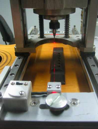

My mill is of a different design, but here's a few shots. The main
points are the same (1/4" shank lam trimmer cutter, linear
bearing travel and plunge, width and depth stops) with a
slightly different layout. Here is a top/side view on a new bridge
I had to slot this morning.
05_223330_bm1.jpg">
I know it's a bit silly and superfluous, but I just couldn't resist
taking the bulb and lense from a cheap laser level and
mounting it on the carriage.
05_223530_bm2.jpg">

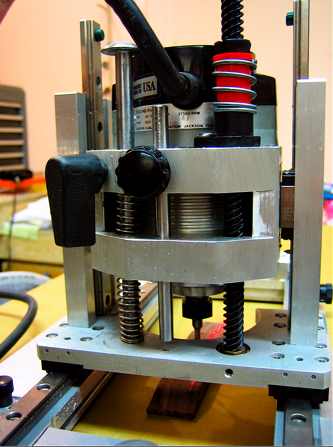

Here is the back with a lead screw for plunging on the right, a
depth stop in the middle, and a spring balance with a lock lever
on the left which I never really use.

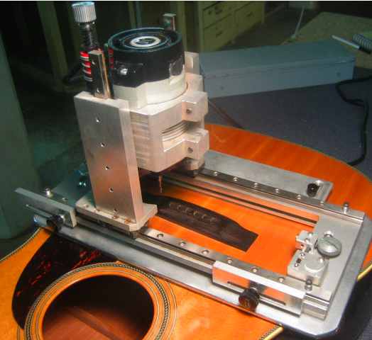

05_223740_bm3.jpg">
This is a shot of the other side with a view of the end stops that I
use. This slot I had to widen out and clean up this afternoon.
05_223943_bm4.jpg">
And on the front side put another stop for odd width slots that
may require moving the carriage for a second parallel pass.
05_224141_bm5.jpg">

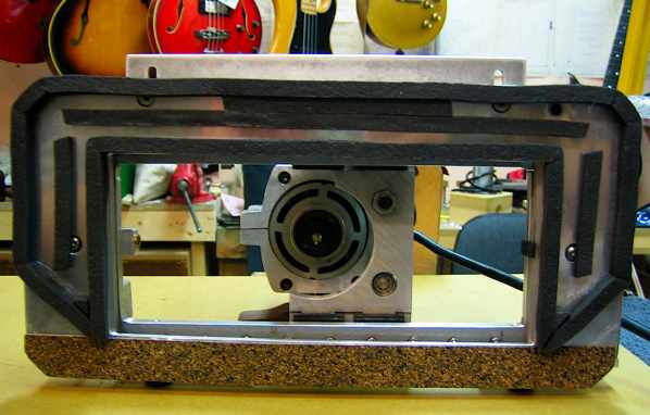

It looks like your rig has a vacuum clamp built into the bottom?
I lined the bottom of my rig with two layers of gasket sealing cork
available at the hardware store etc. This seems to work well and keeps it
from skidding around. The base plate is flat so it does flatten out the
domed tops a bit, I try not to over-clamp the rig and my guess is that any
distortion in the cutting depth is minimal.

I was going to post a shot of the vacuum clamping bottom of the base,
but for some reason I can't get the image link to fit on one line in the text
box today. Maybe I'll try again tomorrow.
PostPosted: Mon Apr 09, 2007 12:32 pm
Posts: 2060
There, I got it to work.

Thanks for posting that bottom shot with the vacuum seals. I built one of
the Joe Woodworker vacuum clamping systems but have yet to fully
integrate it into my shop. Again being an eBay scroung-o-holic I may
have wound up with a vacuum pump that is slightly underpowered for
what I'm asking it to do.
