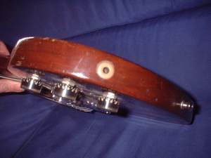

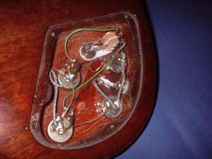

In Case Youre still interested I just took these photos of my 1980 SG
Richard

[QUOTE=Cachalote] In Case Youre still interested I just took these photos of my 1980 SG
Was the side jack done later?
Usually the recesses have finish sprayed in them (routing and drilling are done before sanding and finish).
It also looks like you have the '5 holes in the face' like a regular SG there. I can't tell from the pic if there was a re-wire done at some point.
Interesting. Thanks!

As far as I know its all original apart from having been refretted at least twice and having a healthy amount of dings and buckle rash ( I bought her about 17 years ago second hand ).

Hey those pictures are terrific! Thanks for taking the time to post them. I'd never heard of or seen an SG like this until I got the call from the customer. Now I've got a good idea of what I'm dealing with and lots to go on. Thanks guys
