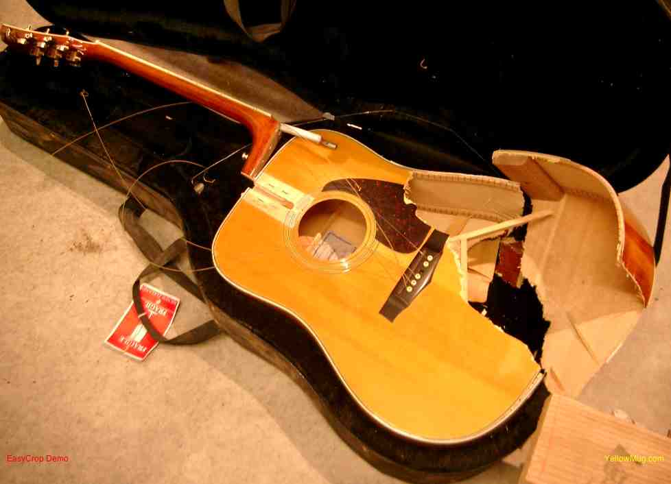

This is my benchmark for damaged guitars
