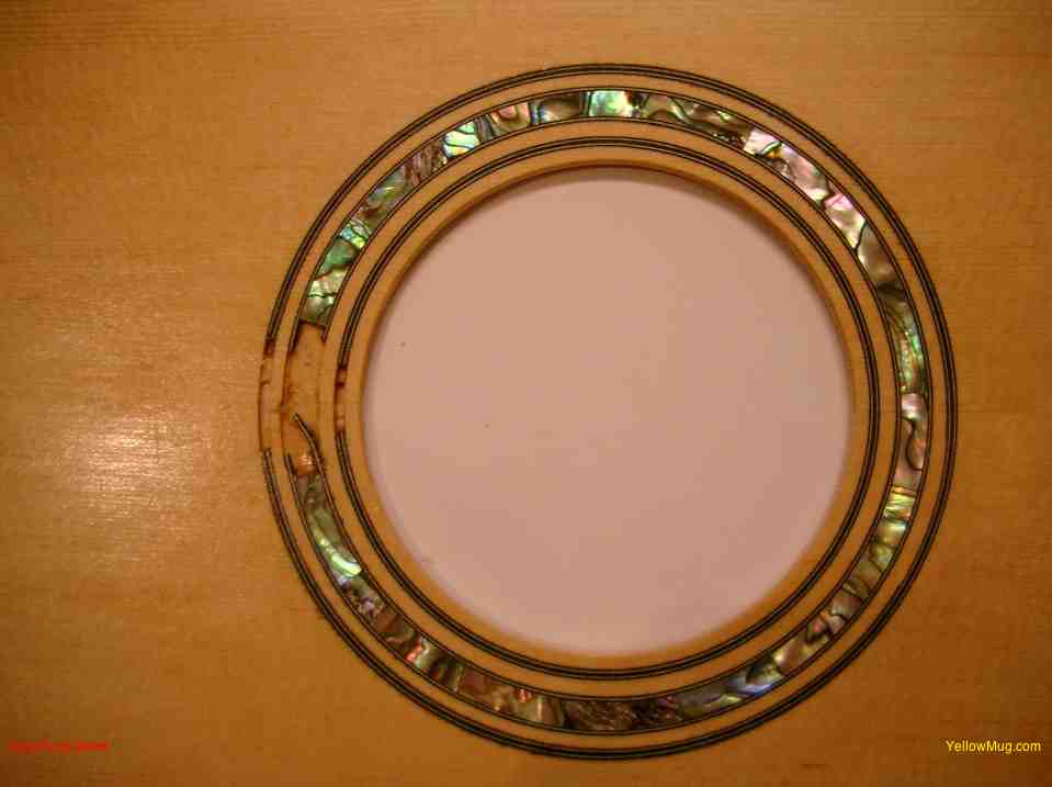

Robert,
Yes, the rosette is paua and it wasnt too hard to do...just laborious. Heres a closeup taken after the rosette went in.

Posts: 174
that paua is gorgeous!
i usually like really discrete inlays, but thats awesome. looks like it goes on forever....hmmm....maybe i should have a re-think....

Cool stuff, that rosette is just so classy. Cheers!

Nice rosette Martin! You have been busy!

Beautiful Rosette Brother!!
The guitars are coming along beautifully.
Good work!

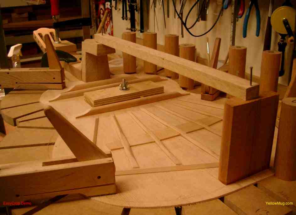

Nice work, Martin. I don't believe I've ever seen a beam connecting the head and tail blocks before. Gluing aid or handle?
PostPosted: Wed Mar 21, 2007 7:50 pm
Posts: 1055
The length of batten holds the butt block square until the sides go on.

Martin, beautiful rosette!
I gotta try that on my next.

Gorgeous rosette, Martin...

Very nice work Martin, Beautiful rosette!

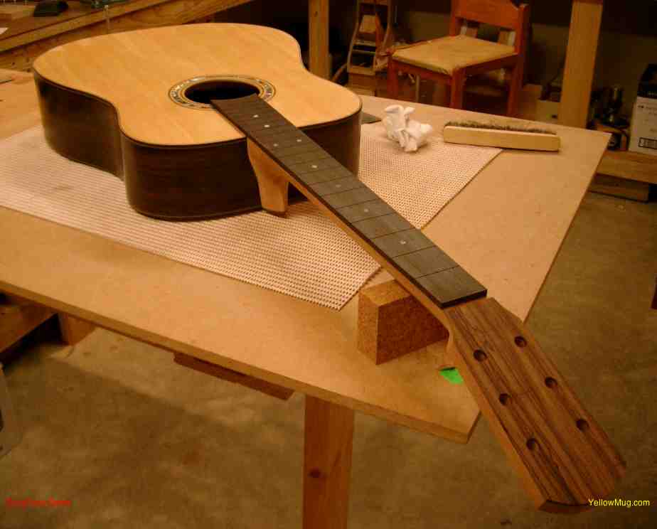

Martin, great work...love the "dreadie".
Is that Indian rosewood? Looks dark and rich.
Like Evan would say, "Yay, chocolate!"
PostPosted: Thu Mar 22, 2007 11:39 am
Posts: 1055
Yes Steve the Dreadie back and sides are Indian Rosewood. Its been pore filled with Z-poxy (two coats diluted 50% with alcohol and sanded back to bare wood) and then a french polish job has been started. Top is Sitka and neck is Honduras Mahogany.
