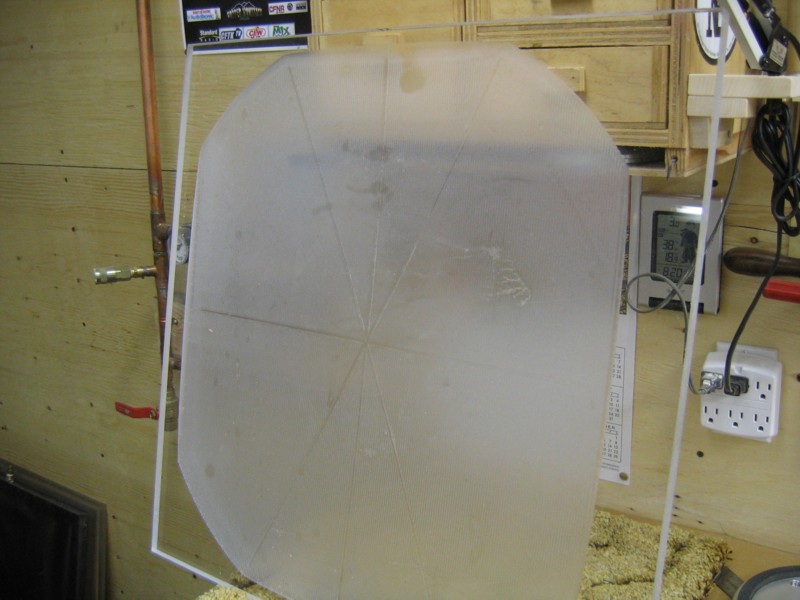

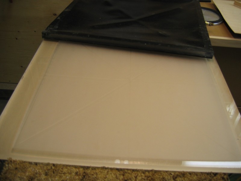

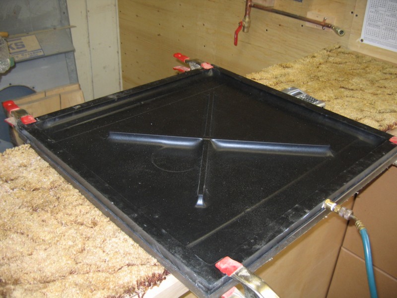

This is a picture of the dish with the lid sitting beside it. These dishes are about 24 inches square on the outside and are cnc milled from 3/4 inch acrylic. The lid in this picture is a glued together frame but we think that for the production models we will mill the lid from one piece of acrylic and will use the piece left from the middle to make bridge clamps.
Here is the system under vacuum with a test piece on my bench. For now we have black rubber but may change the colour if we can find what we are looking for for the right price.

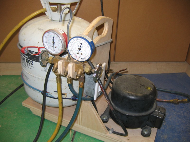

This is a picture of my vacuum pump. Just so you know that you don't require an expensive or elaborate pump system to run these things, this one is built from an old refrigerator compressor and a 20 pound reservoir tank.

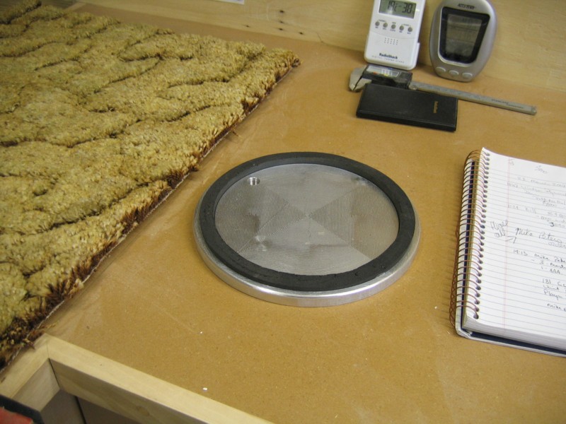

This is the start of my guitar holder. I will be designing a base for it that will be a wood/aluminum composite. We will probably make an all aluminum version very soon but still just offer just the dish so that you can make a fixture that best suits your working environment.

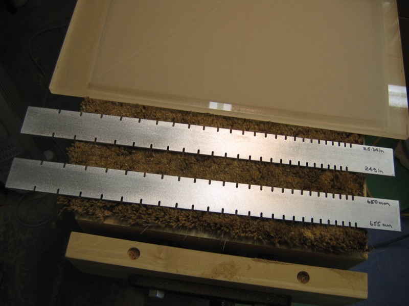

On the "percision tools" side of things we will also be offering fret scales made from 1/8 aluminum flatbar. Here are two that I had made for my guitars.

The fret scales are $36 USD each and will come with a pin that can be installed into your fretting fixture. The slot width is .125 inches.

Seeing that interest has been low so far, I thought I should add a couple more pics that better show these dishes.
The first is a picture of the outline that is formed when the dish is milled. This is a 15 foot radius.

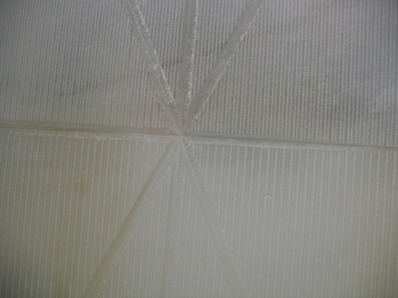

This is a close up of the milling pattern that allows for great vacuum. These grooves are quite shallow but are deep enough to allow the vacuum to distribute evenly throughout the dish.

Your fixtures look really good. My biggest concern would be keeping the lid flat. Once the vacuum is drawn it's not really an issue but it would be nice to keep it flat. If the lid is machined from one piece of rather than seperate pieces this might not be an issue. What thickness material are you going to use for the lids?
As for the dishes, I use 1" UHMW for bracing and 1" MDF dishes for sanding.   The only drawback to the UHMW is that it warps like crazy after machining so the dishes have to be bolted down. The advantage to using two seperate dishes is that you can modify the vacuum jig to accomodate registration pin holes, etc. Plus you don't have to waste sandpaper by removing and installing between operations. It cost a little extra up front but it is very convenient to keep them seperate.

Thanks for the comments, I was a bit concerned about warping but with this acrylic (plexiglass) it is not really an issue. Both the dishes and the lids are 3/4 inch thick. The top and back plate of the guitars will be more flxible than these dishes so they should conform to the dish rather than distorting it. Thanks also for your comments on price, I too think that the price is fair but it is still adding more cost to building a guitar.

I wouldn't be too worried about the volume of air to be evacuated from a setup with a round dish.
I recently laminated a couple of backs and just slipped the 1.5 inch round dish/screen/back/plastic assembly into a large garbage bag and wrapped the bag around the vacuum hose.
The pump (JB FastVAc?) pulled the assembly down in about 30 sec with no reservoir to help. Using epoxy gives the luxury of long working time as well- and most folks gluing braces will be using a 'faster' glue..
For me, it's strictly a case of 'I don't get it' with vacuum clamping for braces (and even bridges) but it seems to be popular and your examples seem very well made. As others have mentioned, you have your well-deserved excellent reputation for quality and service behind you.
I do think there would be a market for a frame that used an existing 24 inch round dish. Making and selling a round 1-piece frame would be expensive, but you might figure out a use for all the cutouts.
I don't get the comment about removing the sandpaper. Why bother? Just lay posterboard (or nylon window screen) over the sandpaper to protect the top. (I assume you have tested your milled surface with a cedar top to make sure there is no imprinting.)
If you are going to market the fret templates, it might be useful to some folks to specify the calculation method you are using for the fret spacing.

I'm with John, I don't think the additional volume associated with a 1.5" existing radius dish is much to worry about. I don't use a reservoir on my Gast pump, and it evacuates very quickly.
Yep, you've run into the same issue Don and I had: the issue isn't really finding a way to produce the jig, it's finding a way to eliminate the significant waste associated with making the unit completely out of UHMW (or some other suitable material). Our design would have used two 28" pieces with suitable pocket cuts in them, but the resulting waste made it cost prohibitive. We found a great UHMW supplier, with CNC capability, but they had cut minimums in place that made our prototypes too expensive to mess aroung with...in the end we bagged the idea.

Michael, The prototype had a barbed hose fitting, but with my compound vacuum gauges I installed a threaded fitting, I think that this is the way to go, my fittings are screwed on with hand pressure for a positive fit and go and off very fast. But I would supply with whatever fitting was requested, as long as it wasn't something that I couldn't get or cost a fortune!
PostPosted: Mon Mar 26, 2007 11:36 am
sorry shane, i wasn't referring to the type of hose fitting, but rather whether was to be mounting clete, or predrilled hoes to which we could affix our own mount, etc.
PostPosted: Mon Mar 26, 2007 11:54 am
AHHH! For the guitar holder! I really haven't got that far yet. As it sits the dish would come just as it is. Machined inside to a dish shape, a channel routed for the gasket and the gasket included and a hole drilled and tapped for the exhaust fitting. You would have to develope it further from there. I will be making this one I have into a holder with a base along the lines of LMI's but out of wood and aluminum. When we make the entire unit it will probably be all aluminum. Aluminum is easy to work with your carbide woodworking tools and drilling and tapping holes is simple also.
Hope that helps Michael.
PostPosted: Tue Mar 27, 2007 12:44 am
thanks shane. my shopmade wooden version has been mounted on a panavise and a power arm. there is no reason i couldn't drill and tap to do the same with the aluminium you will provide. what radius is it machined to and how thick is it?
PostPosted: Tue Mar 27, 2007 1:51 am
Michael, I not sure of the radius but it is about 1/16 inch in 3.25 inches. I can tell the exact the radius when my partner returns. The gasket is substantial, it extends 5/16 above the plate so offers a great buffer in it itself. The plate is machines from 1/2 inch aluminum.
PostPosted: Tue Mar 27, 2007 7:15 am
Michael the radius is 10 foot. Along the extra thick gasket there is no way the guitar will ever come in contact with the aluminum....when used as designed .

Are your fret scales similar to Stew Mac's notched straightedge so they
could be used for checking the flatness of a fretboard?
If so, this is a tool I'd like to have in my stable.
Christopher C. Cordle
North Muskegon, MI
PostPosted: Fri Mar 30, 2007 3:42 am
Hey Chris, I guess it could certainly be used for that purpose. These scales are made from 1/8 by 2 flat bar aluminum so the edges are not machined. If I wanted to use it as you have described I would lay a piece of sandpaper from my thickness sander on a nice flat surface, like my tablesaw, and sand the edge, using the saw fence to keep the edge square. I would then check progress with my straight edge. Alternantvely we could probably machine the edges but that would cost more. But as Tony says.....nothing is impossible.....
