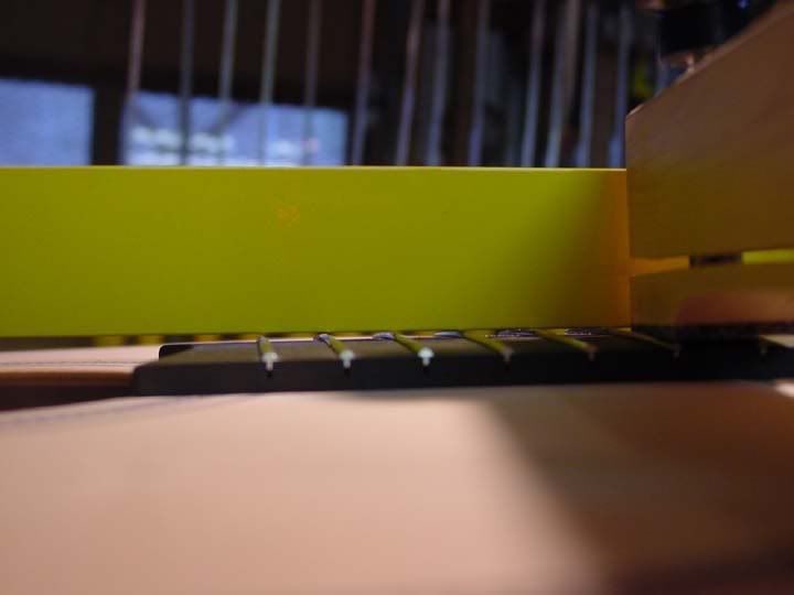

The fingerboard is fretted, the upper bout has been trued, I have done the flossing to achieve
proper neck angle. (So I think)
Here’s what I got;
Picture #1. Shows full view

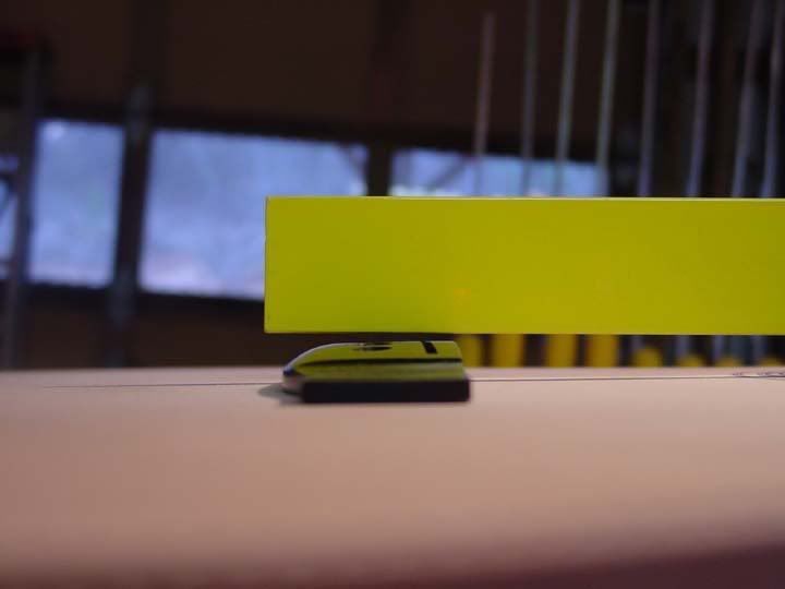

Picture #2. Looks like a pretty straight neck.

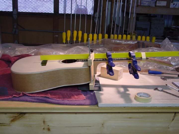

Picture #3. Shows a gap of about .015" at the 20th fret, the fretboard starts to fall at the 16th fret.

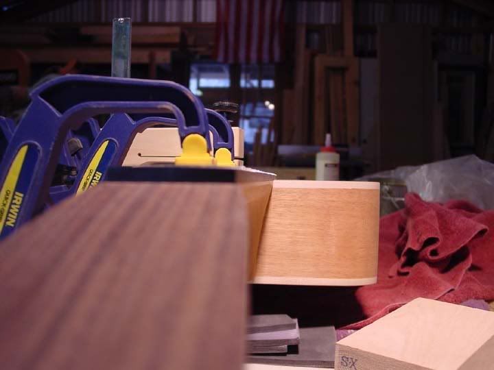

Picture #4. Gap at bridge is .060"

Will this give me an approximate 1/8" saddle?

Robert, the fall after the neck joint is not an issue. Many builders work this into there designs to prevent the dreded 14th fret hump. The gap at the bridge looks like more than .060 but that could be the photo playing tricks on my eyes. If indeed that is the case, you are in good shape. I would run with it the way it is.

Paul, It was so close to .060", that I just rounded it off, I think it was closer to .062", or .063"

Terry, I do find myself wondering if the string tension will be a factor, in that, it will cause a larger
gap at the 20th fret.
