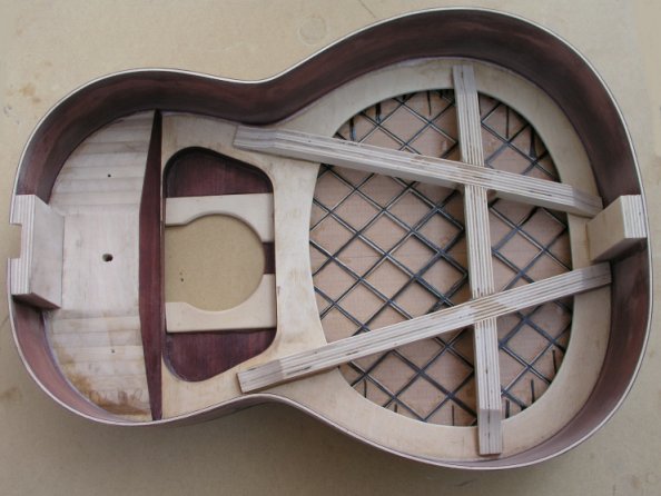

PostPosted: Sat Jan 06, 2007 11:05 am
[QUOTE=Hesh1956] This picture was posted prior and facinated me to no end...... and it seems appropriate now to show it again.
I don't recall what the thread was about or if this is even one of Ervin's guitars - Brock do you recall when this was posted and what the story is/was?
Yeah, this is one of Ervin's guitars. IIRC Dave Bland posted this from his course, but I have a bunch just like it.      That is a good example of where the box is in construction when he braces it.
Also... notice how all of the braces are coupled (or nearly coupled) to the bridge plate.
I don't know if Ervin would agree with this thinking or not, but one of the things I came away from the class thinking was that braces are more like "irrigation ditches" that channel the energy through the top vs. structural supports that keep the guitar from imploding.
I realize they do both, but shifting my thinking to PRIMARILY the ditches model has made a significant difference in my post class guitars.

Few things I notice when looking at this top bracing - the upper transverse is not scalloped at the sides, or at least not much anyway - seems to run in full height, then the kerfing is buttressed on top of it - very stiff (same idea as in the top tapping mold Ervin has in the videos). The soundhole braces are fully coupled at the X, but have a taper down to uncouple them at the upper transverse. NONE of the other braces are tucked. The back braces will be tucked - see the notches in the linings. Oh, the lattice on the bridge plate is NOT coupled to the X directly, and no side supports of any kind.
PostPosted: Sat Jan 06, 2007 2:37 pm
[QUOTE=TonyKarol] Few things I notice when looking at this top bracing - the upper transverse is not scalloped at the sides, or at least not much anyway - seems to run in full height, then the kerfing is buttressed on top of it - very stiff (same idea as in the top tapping mold Ervin has in the videos). The soundhole braces are fully coupled at the X, but have a taper down to uncouple them at the upper transverse. NONE of the other braces are tucked. The back braces will be tucked - see the notches in the linings. Oh, the lattice on the bridge plate is NOT coupled to the X directly, and no side supports of any kind.[/QUOTE]
Again, I can't speak for Ervin and why he does what he does. But.. his rims ARE very stiff. They are laminated from two thin sides with exoxy and when the linings are in they are MEGA stiff. The thinking was that they become like the rim of a drum and don't absorb energy from the top.
And the lattice that connects to the bridge plate doesn't NEED to connect to the X brace because it is picking up the energy directly from the plate.

How does this beast fit in this scheme?
This is David Schramm's take on the Smallman guitar. Referring back to Ervin's picture of the classical vs steel string active soundboard area, this takes the notion that the classical soundboard is dead above the lower transverse brace to the extreme - I think this thing is structural plywood above that region. In contrast, the active area soundboard is drumhead thin - about as monocoque as one could imagine. The top doesn't have to provide any structural integrity for the body, just resist the local string pull.

It really surprised me when David Schramm who has studied Hauser's contruction so extensively ventured into Smallman construction and then even more surprised when he liked the sound of it!
The foundation of the Modern Classical Guitar comes from the Spanish guitars that Torres built. Hauser modified his German construction to build a version of that Spanish style of construction but Smallman is going in a completely different direction.
Everyone that has heard a Smallman remarks on its volume but very few when discussing a Smallman will mention tonal color or quality. When you look at the inside of one of Erwin's guitars or any other quality built instrument you will be able to see the craftsmanship, even before you have heard it.
When I look at the inside of a Smallman school guitar it looks much more like the interior of a speaker cabinet than a musical instrument. To each his own but to me plywood never looks good in a guitar.
I think the stiff rim is the one element that almost everyone agrees makes complete sense, bracing patterns can work in various configurations, but it is all of the elements together that define the sound.
One last thing...when I was playing in garage bands back in high school many years ago we would have really junky amps with cheap speakers...we could crank them up to the max but while the sound would get louder, it never got any better because the speakers were the weak element. The same music if played on quality equipment with good speakers would have projected much better at much less amps because the speakers would be projecting the sound in a more balanced way.
That is how I think of the sound of my tops when I am building and voicing them...the quality of wood for the top determines how thin I can take it, the balance of the braces and voicing controls the shape of the sound that it puts out.

Curious. I haven't heard anyone comment on the kerfing in the picture posted by Hesh.
It would appear that there is 2 rows of kerfing on the bass side.
Can some one explain what I'm seeing and why?tony39090.4566203704
PostPosted: Mon Jan 08, 2007 3:04 am
Joined: Sun Apr 09, 2006 3:26 pm
Posts: 118
Optical illusion. I think my eyes were tricked because of what appears to be the top wood showing between the two lines of kerfing (at the waist).
With bracing so radically different from what I would have expected to see, my mind was prepared to see anything...
