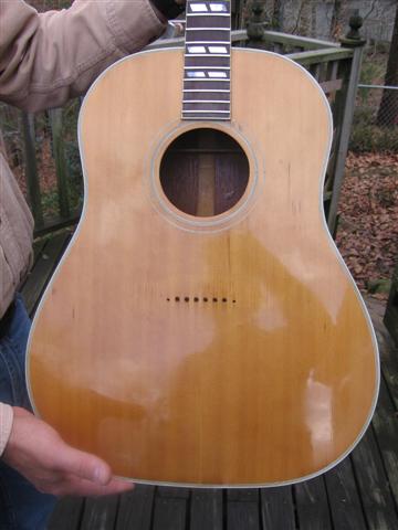

Here is a Gibson from 1958. It's been in my buddy's brother-in-law's closet for 25 years. He was going to refinish it, but never got it done. So here it comes in a box a few months ago.

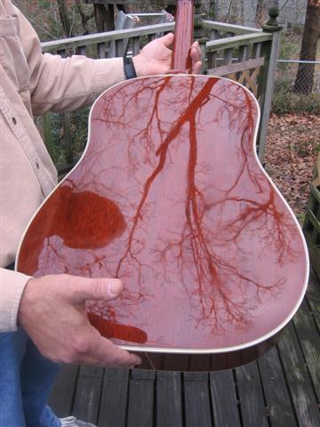

To the owners delight, we buffed out the new 25 year old wet-sanded lacquer finish to a high gloss. He was ready to put it back together satin and ugly. That's when we discovered it wanted to be buffed. So he's getting back the used Gibson his dad bought him used when just a boy.

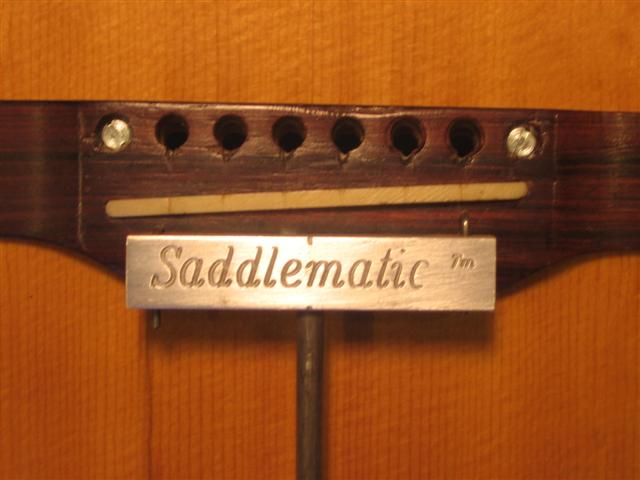

We measured the scale length and get 12 5/16 to the 12th fret, which gives 24 5/8 at the saddle. With the bridge bolted in place, it appears to be 1/8 inch past that to the front edge of the saddle. We are just confused as to the scale and want desperately to get the intonation correct by correct placement of the bridge. The pin holes prevent moving the bridge, but it could be slot-filled and re-cut in the correct position.
Any knowledge on this 1958 Gibson? It used to be a sunburst.

Maybe it is the pic... but if this isn't a refin... why does it look like there is finish under the bridge area?
Did gibson glue the bridge on top of the finish?

Brock, I see 8 holes at the bridge location. I'm betting this is one of the infamous bolt on bridges.

Brock, the brother in law was doing a refinish, but never gave the guitar back, and didn't get done. You are right it is finished under the bridge area, so he was doing it right. Well, except for sanding off all the sunburst.

Don, it is a bolt on.

I'm thinking my friend needs to fill the slot and re-rout the new saddle location. What do you think?

what distance is the saddlematic set to?
if it is set to the nut-12th distance, the distance from the saddlematic pins to the saddle looks about right for compensation.

Hi Michael, The Saddlematic is set on the Nut to center of 12th Fret distance. The pins already have the compensation set for a Martin 25.4 scale. StewMac says that the difference is very slight from short scale to long scale guitars. In other words, don't bother.
So using the SJ Gibson 1958 fretboard, the pics show the excess length of the scale. It's about 1/8" too long for the scale, which turns out to be 24 9/16 inches plus a little for compensation. WE are just too long for the existing board. And, we want to get it right for this sweet old guitar.

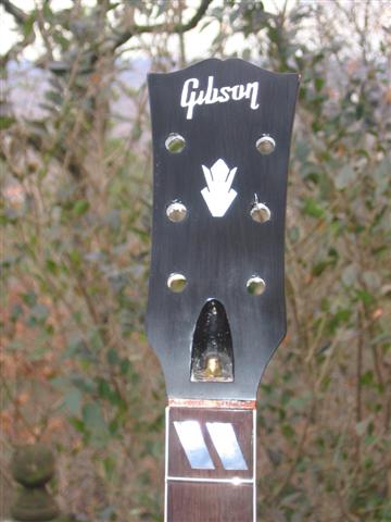

   It may also be the southener jumbo series can you get a picture of the binding detail?
    The southerner has tortice and teh SJ has black pickguard.

My friend is indeed holding his SJ Southern Jumbo his dad bought him used. It was previously used in a gospel group and purchased second-hand for him.
The kind brother in law, took it to refinish it for him. That is why it is missing the sunburst. After the lacquer job, it never got buffed out. It actually was gone for 28 years, but was returned just a few months ago when after a funeral in a distant state, he himself brought it up. Then came the box with the guitar much as you see it.
We convinced ourselves that it was buffer-ready, and it was. The finish is great. A new tortis pickguard will cover many top uglies. That's when we decided to check the bridge... and found the discrepancies of excess compensation. Pretty close to an 1/8 inch in excess of normal compensation.

don't bolt it on with the bolt holes in the bridge. what i was referring to are special purpose hollow bolts s-m sells for testing purposes. you use one in each pin hole and the string is passed through from the inside. using only the bolt holes in the bridge could cause damage.
