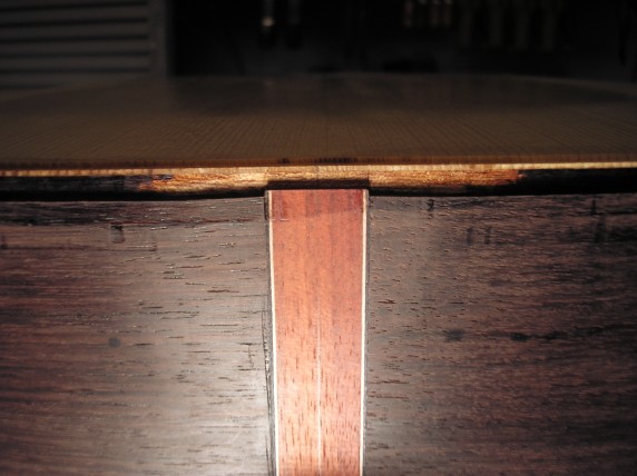

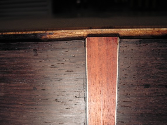

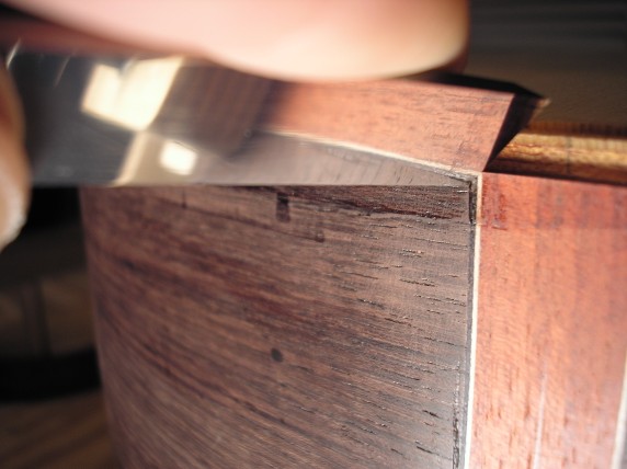

Well,I thought I would post a few pics of my first attempt at this fun part of building. The first is the wedge trimmed and ready for the 45*.

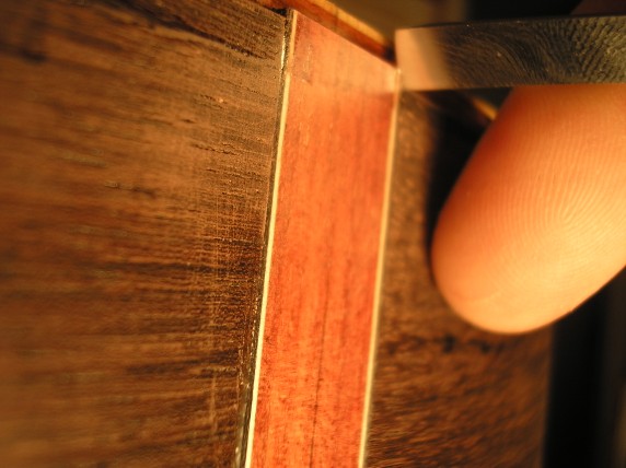

Here I'm cutting with a 1/4" chisel(VERY sharp btw)
Here is the reflection on my polished chisel.This is a
neat trick!
The 45's cut.

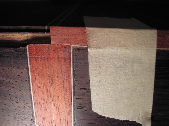

I cut the binding to size and it fit (after a couple of trys)
Success! Now three more to do....

Almost there buddy! Looks better than anything I have done. I dont do mitres, like windows and such. You get big props from me for trying and making the first one look great. I bet the whole thing is going to be pretty.

Nice Dave...that's a big step up the skill ladder. Your chisel is perfect for the job...nice and scary sharp! Congratulations!

Looks great! Fun, ain't it, specially when they turn out well.

Nice pictorial Dave, thanks. I still need to try that.
Is there any trick to ajust and trim the wedge at just the right heigth?

Thanks guys,It is fun doing this stuff.I think on my next guitar If I ever get to it, I'll use 3 purflings. It seems like it would be a bit easier to cut the 45's.I wouldn't want to try only a single line!
Alain- I just trimmed the wedge and used a needle file to get the heighth to fit with the binding.

Great job. I didnt realize you cut the mitre and left the top portion of the end graft equal to the top point of the mitre. Looks like I have been making more complicated than it is. Thanks for the pictures

Right on Dave! Great looking work. That's the best trick, the old 'use the reflection' ploy. Works great.

Is that Mahogany binding you got there Dave? (Wood recognition is one thing I can certainly get better at)
That looks nice indeed. It would have been nice to go with another white purfling line as the black will almost disappear on you against that dark EIR. But these are the things we learn along the way.

Nice work on the mitre cut...the reflection trick with the back of the chisel works really well.

Nice job Dave! The closeup pics do a great job of showing the detail. Very clean shop you have there as well.

Rod-yeah, I noticed how the black purf is hard to see against the rosewood so on the next one I will do another thin white as you say.

[QUOTE=DaveAndy] Here is the reflection on my polished chisel.!
Okay, now you're just showin' off!    Being a miter maiden myself, my hat is tipping in your direction.

Neat trick with the chisel. Is that a Blues Creek Guitar cradle you’re using for additional support of the guitar body? Another neat idea. Wow and looking good.

Mlloyd- That is the guitar cradle from my binding jig, from LMI. I use it to hold the guitar for a lot.Just clamp it to the bench and sand or whatever.
