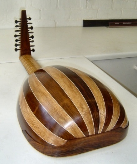

Now I've been thinking about doing this for quite some time, a sort of natural extension of my lute shells, and certainly much easier to construct than lute shells. They could be built up on a form in precicely the same way. All you'd need to know is the angle of intersection of each element of the back, though that can be arrived at by trial and error. I personally don't like the small cleats that are sometimes used to reinforce the joint on the inside, but do like the fact that the structural strength of the back is from it's shape rather than the additional braces that we traditionally use. I would reinforce the joint with silk tape as I do with the lute shell. The more segments used then the easier construction becomes.
Look at a lute shell, they are just the same, the lute is just more exagerated.
As to volume, I've never seen more and greater volume as the holy grail. I think that often this is at the cost of tone. If you listen or, like me, play some of the 19th century or earlier guitars they have a sweetness of tone that is lacking in the offerings we have today from our pursuit of volume. What the bowl backs do however is focus the sound, and the stiffness allows the top to operate. Volume from lutes often surprises guitar players, although the opening of the rose is only a small proportion of that on a guitar soundhole, both volume and projection are far higher than most people imagine.

now that picture of the back of the lute...imagine that
on a guitar...I think it would be staggeringly beautiful
surely worth a go just to see what it soundede like..I
just cannot beleive that it would sound
bad..especially if the builder (like yourself) is well
veresed in lute as well as guitar building...would I
buy one...if I could afford it AB---SO...LUTE (no
pun)-LY
some one build one PLEASE!!!!

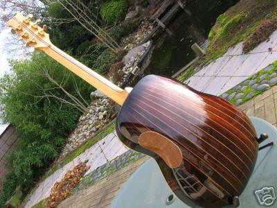

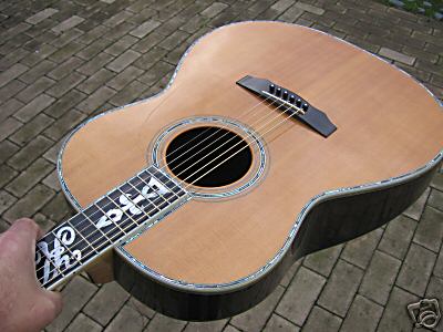

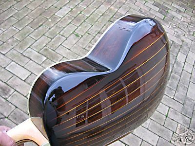

i stumbled across this one while e-baying...a good looking one eh?

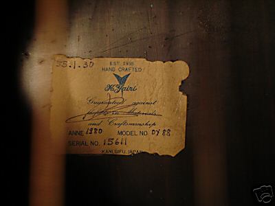

forgot to mention its a YAIRI.

WOW WOW WOW WOW, ever nice! Thanks Udi and Happy New Year!

That Yairi is georgeous.
I love the idea of using a piece of suede on the back
to prevent the guitar from slipping away from the
player...Anyone got a few grand to donate to a good
cause ..(me!!!!).
