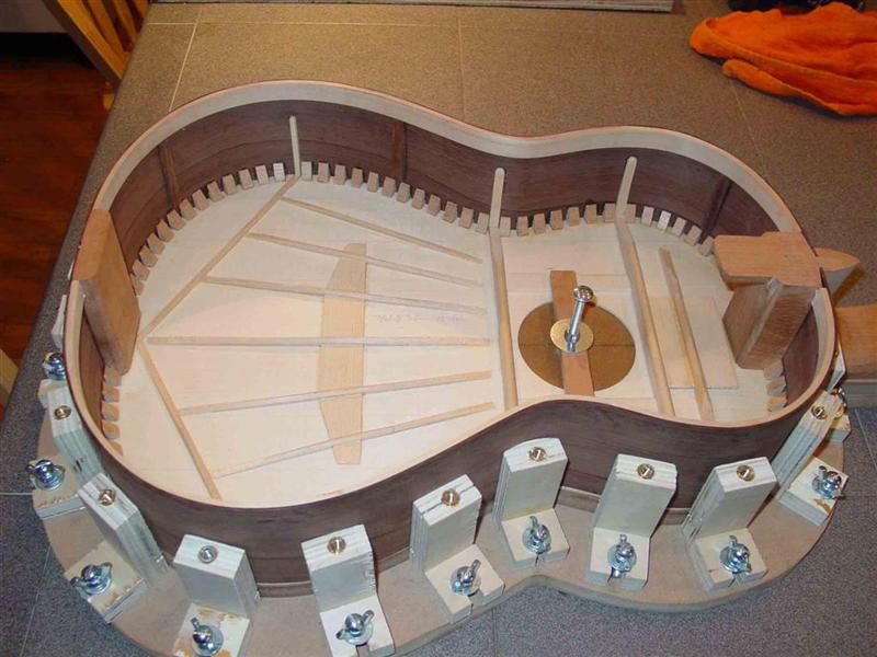

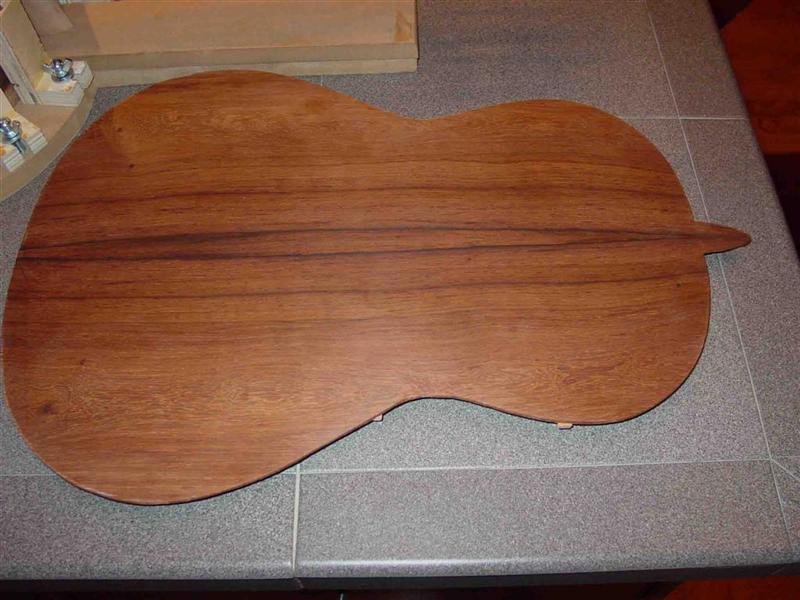

This is just about ready to glue on the back. Here are the specs and materials list:
Plantilla is from a Tezanos-Perez Maestro
Depth at tail block = 104mm
Depth at heel block = 97mm
Solera depression 2.5mm at bridge
Braces "sprung-in",
Back/Sides: Madasgascar Rosewood from Vikwood
Back Braces: Spanish Cedar
Top: Engelmann with lots of hazelfletch (sourced from a local supplier here in Portland)
Top Braces: Sitka
Dentellones: Spanish Cedar

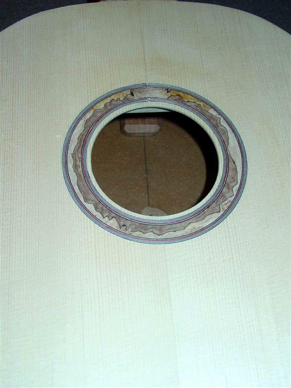

Rosette: Spalted Maple
Back Lining: Solid Sitka
Neck: Spanish Cedar
Starting to look like a guitar

Nice looking Classical there Mark. Love that Madagascar.

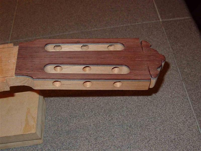

Great work by the way, love the headstock and the

Yeah, I'm with Bruce. The Madrose is gorgeous.

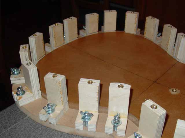

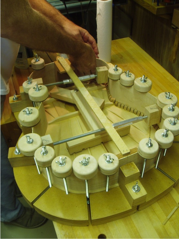

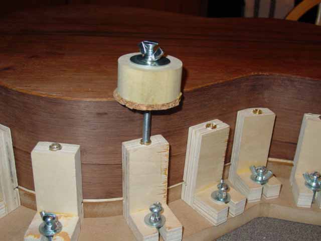

Nice, very clean work. Great choice on woods. I'm using a very similar bracing pattern on a couple I'm building. What do you think of the engelmann so far, I'm using it for the first time on one of my builds. Also, what are the threaded inserts on your solera braces used for?

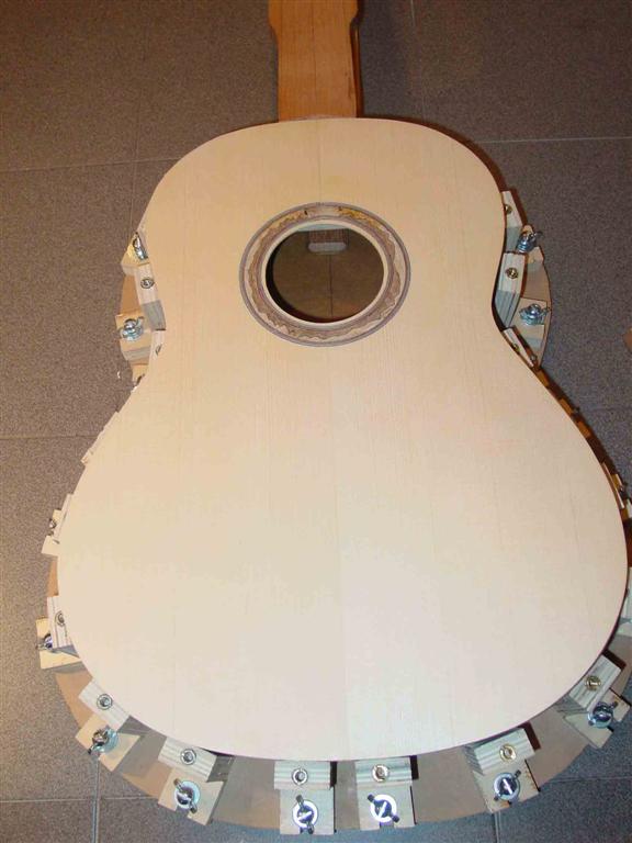

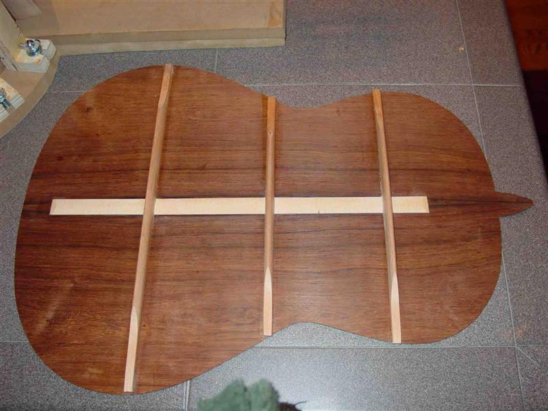

The threaded inserts are for shop-built spool clamps to hold the sides to the top while glueing on the dentellones (or kerfed lining) and for glueing on the back. I cut the spools off a large dowell and glued on some cork. The dished-out solera fits into the workboard extension with the moveable blocks, and the neck extension is planed to the proper neck relief - at least I hope it is right, I just built this assembly jig a few weeks ago! These pictures show the parts. So far this jig is way better than using a bunch of assorted clamps and cauls for assembly.
I like the Engelmann very much - not as stiff as German so I start out a little thicker (~2.9mm) before selectively thinning around the bridge graft. I have several tops from the same piece of tree cut many years ago and they are working out well.

My solera slots accept either a spool clamp or a vertical brace, and there are extra holes for more spool clamps. I like the way yours works better, more clamping options.
