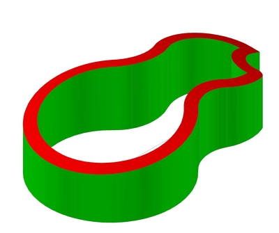

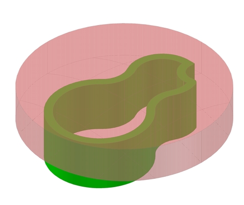

I am creating a 3d model with a Sphere and cookie cutter it will be a bit but I will post when done

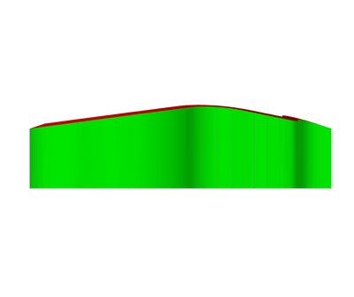

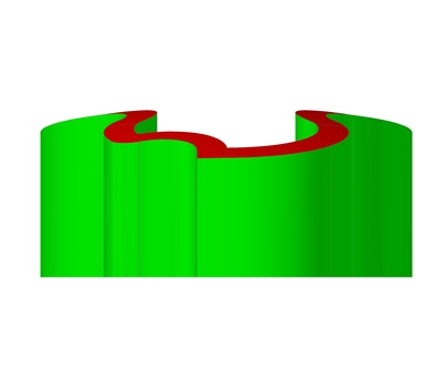

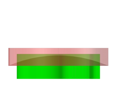

Ok! here are the pics
The first two are a side view and isometric view showing a guitar shape and a transparent sanding dish. I decrease the bowl radius a bunch to make what happens easily visible
Next is an isometric view of the rim sanded. I made the rim thich to eliminate drawing all components. Followed by side and neck end views The red is the surface left by sanding.
Notice the waist is the tallest part of the profile because it is the closest area to the center axis of the dome. The neck and heel occupy the equal elevations but all other point are subject to their position of intersection with the dome or sphere. Now this is exaggerated. by the small radius I used.
