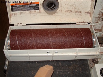

Hesh, Those pictures are great! I don't think I have ever caught a good look at that clip because it is kinda awkward to see. You motivated me to take a look at how I wind(especially because I do start at the sprung side, and it has given me no issues).
I realised that when I start winding I clip the paper(and this is on the sprung side) then I wind the drum once around(to get the paper alighned. I had ahold of the drum through the end with my thumb on the sand paper. When I straighten and snug the paper I noticed the I pulled the paper tight, it also pulled back on the spring. Then as I wind I keep the paper tight with my right hand as I guide the paper onto the drum with my left. When I get to the open end my right hand thumb is placed on the paper and I pinch the fixed clip open with my index finger. I feed the paper through the clip with my left hand, still holding the paper and clip with my right hand. I then grab the tip of the paper(It is easy to grab on the open end of the drum) and wiggle it to get it seated well and give it a good pull as I release the paper and clip with my right hand. After watching the spring side through the process, I noted that I never release tension on the spring(looking at the spring clip as best I could it looked like it may have slipped a bit, but was still tensioned). I also tried reversing the process and finishing on the sprung clip, but could never get the same tension(probably because I am just not used to doing it that way).
I took a picture of my drum. It has 60 grit on it right now. As memory serves, I surfaced approx 20 Spruce soundboards, 4 B/S sets of Koa, 2 B/S sets of Pink Ivory, 2 B/S sets of Myrtle, 2 B/S sets of Sapele. Surfaced Several set billets, 2 Snakewood Fretboards, and a handful of other things that are not coming to mind right now.

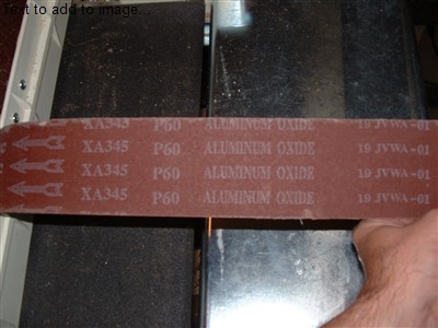

This is a shot of the back of the role(cloth backed Aluminum Ox). I don't know what brand the paper is, but it seems to do a good job.
