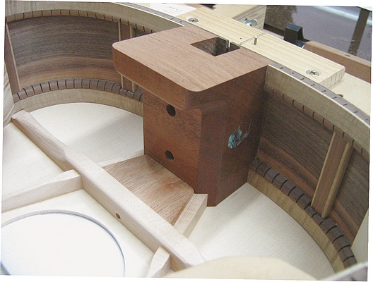

           Capped linings are a two piece arrangement. Charles Fox introduced this idea.
Here is a pic of mine ;
I used Walnut for the kerfed part and Tasmanian Sassafras for the capping as a contrast.
Cheers, Craig Lawrence

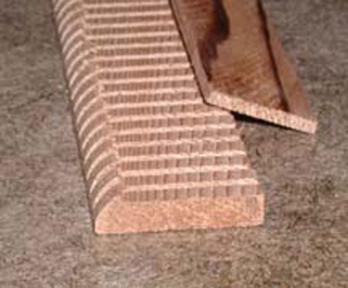

Dave, Here is another more detailed pic of the fox liners ( NOT MINE )

            The only dimensions I can give you are the ones I made ,which are 25 m.m. X 7 m.m. for the main kerfed part. I then take out 19m.m. X 2 m.m. for the capping.
The Charles fox ones may differ slightly in dimensions.
Paul Woolson made some up for fellow Olfers some time ago.
Hope this helps.
Cheers, Craig
