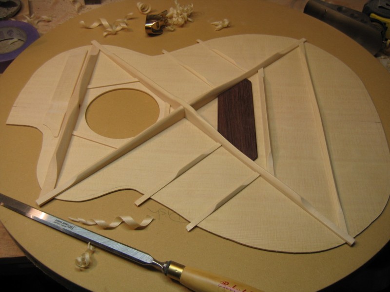

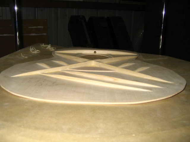

Here are three ideas I'm working on. The first picture is of two tops which have not yet been voiced (carved to final height).
This one is voiced but not yet cleaned up:

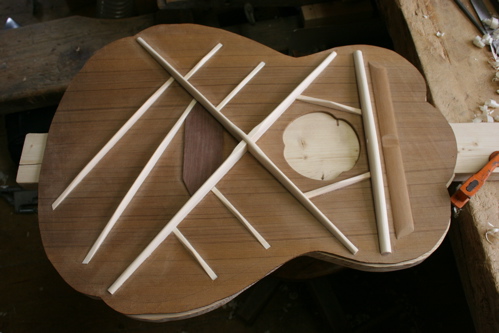

i have yet to build an acoustic but have worked on many in the last few years.  This is the R. Taylor style 1 bracing patterns.

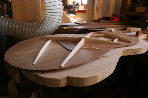

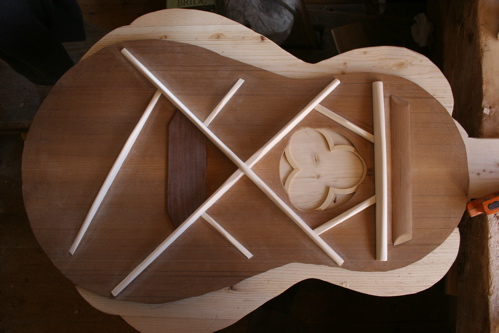

Here are a couple for variety.
Something Different
and another

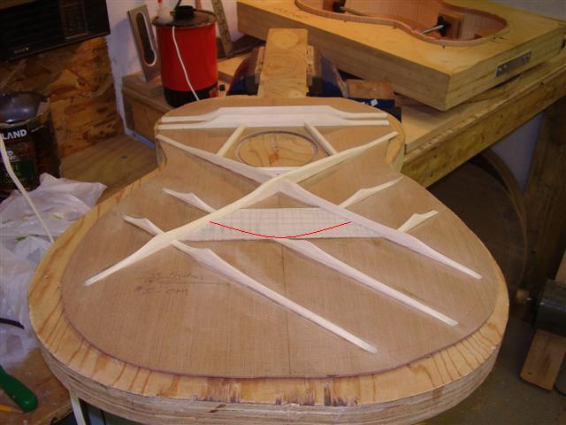

PostPosted: Mon Apr 30, 2007 4:51 pm
JJ and Hesh,
I don't do a curved bridge plate but my guess as to why some folks do is..........here it comes..........
Weight kills tone.
Take a look at how much plate would be gond if I curved mine. Thinking twice now.

PostPosted: Mon Apr 30, 2007 6:06 pm
[QUOTE=Rod True]
Weight kills tone.
Hey Rod,
That's a pretty "heavy" statement . I'm not sure I fully agree with that as it stands. It's all part of the overall design and sometimes more weight can "shape" the tone to where you want it to be - sometimes lack of weight can lead to a very thin sounding "tine".
If you want a light bridgeplate then why not use spruce with a hardwood overlay where the bridge-pins will be?

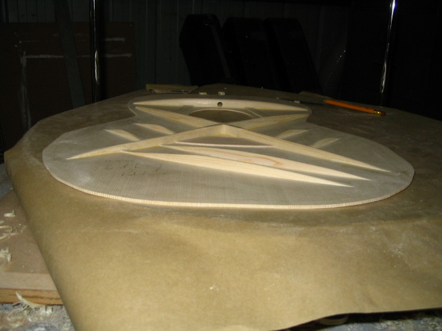

Here's Mine
They are actually coming soon....really

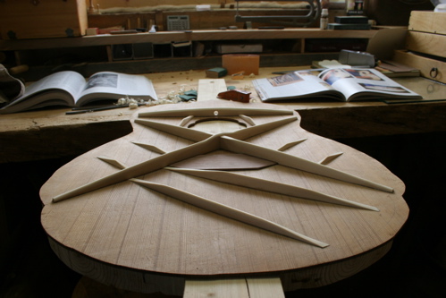

I mentioned before that Hesh gave me a tip on reducing the tone braces which really helped in opening up the top of an OM
Here's the before and after pics.
Before
After
Bob Connor
Geelong, Australia

Lookin' real good now Bob !

PostPosted: Tue May 01, 2007 12:18 am
The curved oversize bridgeplate. Just like many other ideas, bridge plates have gotten larger.
I started off with a precise Martin copy. Then one day, I was feeling around inside one of my Taylors and noticed the larger bridgeplate. One piece of tin foil later, and a slight massage and out comes a pattern for the current bridgeplate I'm using.
To me, the purpose is to provide more rotational stability for this region of the top. We've all seen bellied guitar tops. Taylor goes one step farther, they curve the forward edge of their bridge, ever notice?
By curving it forward and making it wider than say a standard Martin Bridge, it helps with the bellying up behind the bridge problem.
I look at the RTaylor bracing scheme on the R. above and it really makes me scratch my head. Might be the greatest thing since sliced bread? Time will tell. Nothing wrong with experimenting.

PostPosted: Tue May 01, 2007 1:12 am
[QUOTE=Dave White] [QUOTE=Rod True]
Weight kills tone.
Hey Rod,
If you want a light bridge plate then why not use spruce with a hardwood overlay where the bridge-pins will be?[/QUOTE]
Hi Dave,
Your right that was a heavy statement and one I should have thought through more before I posted.
There certainly is a fine line between the weight in the correct place and in the wrong space and weight in general. I'm a rookie of course and just wondering and thinking that the curved bridge plate would have reduced weight to possibly aid in loosening up the top.
I do like Bruce's thought on the curved plate in that it helps combat rotational pull.
Bruce, I'm quite sure that Olson scallops his lower tone bars and I normally do as well, just this top thudded with very little response before I took them down as much as I did. Just trying to make it sound that I thought would make a good sounding guitar. Sure hope it works

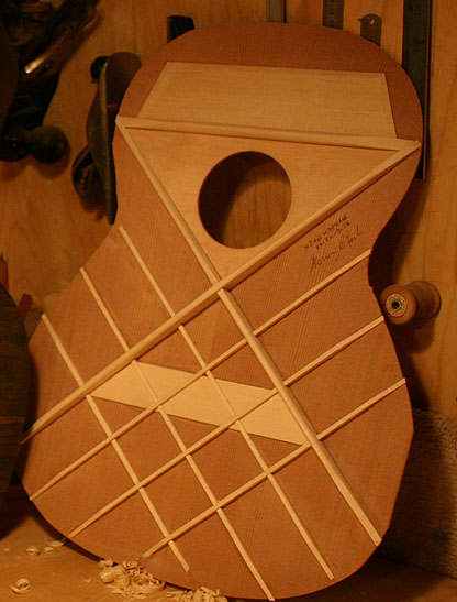

De Jonge-inspired lattice pattern used on my classical.
